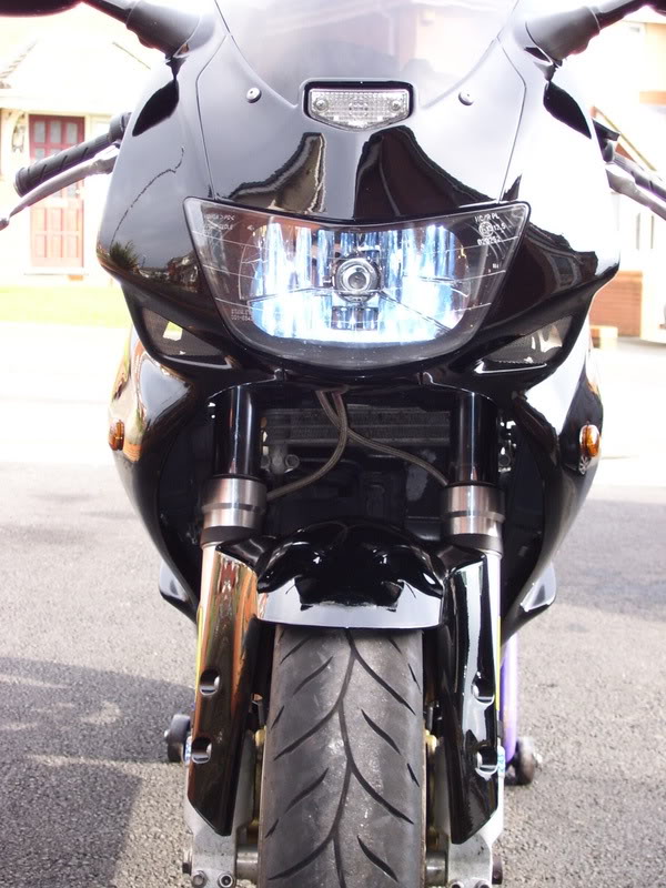

mak595 Feb 23, 2007 08:01 AM
All finished
8 Attachment(s)
:cool: :cool:
Attachment 31633
Attachment 31634
Attachment 31635
Attachment 31636
Attachment 31637
Attachment 31638
Attachment 31639
Attachment 31640

mak595 Feb 23, 2007 10:03 AM
Originally Posted by superbling (Post 42668)
OK, out with it: details, man, we need details.
ok
Revalved fireblade forks with ohlins springs
BSB spec spondon adjustable offset yokes (currently running 27.5mm, Knockhill track settings)
Triumph daytona clip-ons
R1 mudguard
spondon billet caliper mounts
braded brake lines all round
SBK pads
indicator holes in fairing plastic welded up and new smaller holes drilled for new flush mounts
sharkskin lower fairing
Alumminium mesh in intake holes
dark tint screen
ohlins steering damper
polished footpeg assembly's & top yoke
alumminium pegs for better feel
penske rear shock
black frame and swing arm
total respray in black with honda wing tank decals ( british bikes had firestorm decals :shocker: ) and red VTR on fairing
clear rear light & mini indicators
pyramid undertray
carbon hugger
K & N filter
dynojetted
high level fuel titanium cans with removable baffles
dunlop qualifers (180 rear)
errr...i think that's it........
.....for now ;) ;) ;)

JamieDaugherty Feb 23, 2007 03:39 PM
What's the story on those caliper brackets up front? They look like brackets for oversized rotors, but the rotors appear stock. It caught my eye because the calipers do not look like they line up correctly with the rotor. Is this just the angle of the photos or is something else going on?

Hawkrider Feb 24, 2007 04:30 AM
Looks to me like they convert the 900RR caliper mount to the VTR calipers to allow them to work with the stock VTR wheel. At least that's what it looks like....:?:
mak595 Feb 24, 2007 12:57 PM
yep
mak595 Feb 24, 2007 01:05 PM
Originally Posted by mikstr (Post 42727)
frame and swingarm: paint or powdercoat? please.....
Painted, alluminium etch then celli black, i'll see how the finish holds up over this summer, might get it powder coated next winter...
......along with a VFR swing arm ;) ;)

JamieDaugherty Feb 25, 2007 08:56 AM
Except the calipers and rotors are both the same as the 900RR. ??? I'm still not sure why the brackets are necessary and it still looks like the calipers are not in the correct placement for the rotors.
mak595 Feb 25, 2007 01:11 PM
Because it running spondon yokes that are wider than stock, the mounts are used to space the calipers back towards the disks, if you get my drift.
Hawkrider Feb 26, 2007 05:23 AM
Ah, cool. So I guess this required different wheel spacers too. What about axle length?
mak595 Feb 27, 2007 11:54 AM
not too sure, this set up was done when a bought the bike, looks like a genuine (honda?) part rather than a bespoke item.
