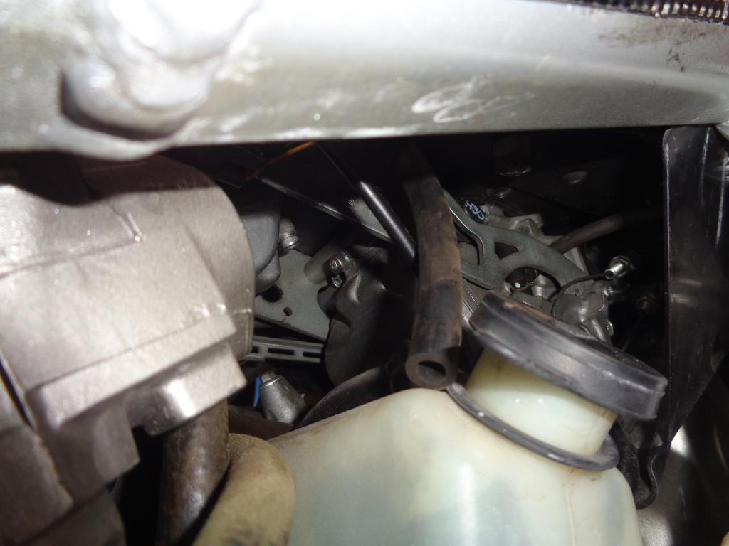

Firstly, I pulled out the hoses under the carbs,
Attachment 32551
took off the rubber bands,
Attachment 32552
and put the hoses in a downward position, not really sure if this is correct, but didn't seem to have any effect, didn't make things better or worse !
Attachment 32553
Attachment 32554

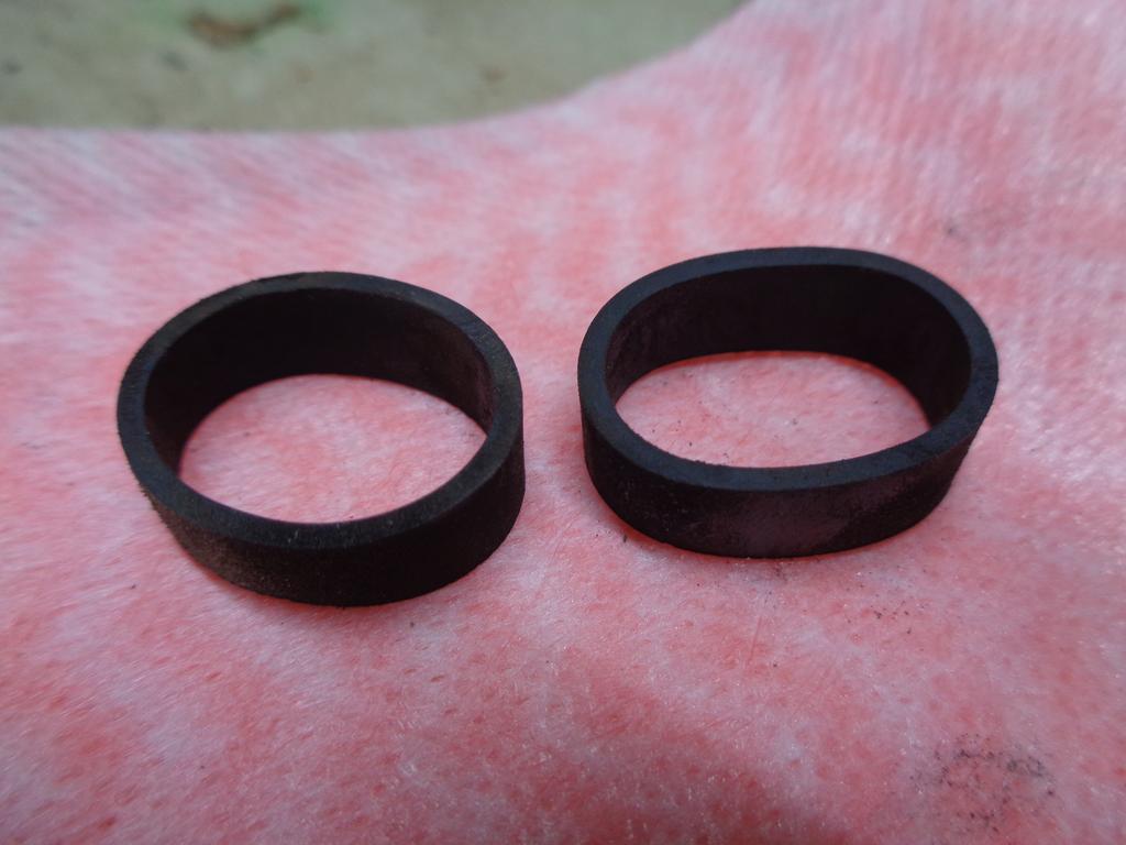

this is when I discovered that the carb filters were badly deteriorated and would probably take a few weeks to get new ones,
so, thought I would for now, make some out of lawn mower pre-filter and a squirt of K&N filter oil to get me by until I can get some new filters,
I just made a paper pattern, then cut out the foam filters,
Attachment 32549
Attachment 32550

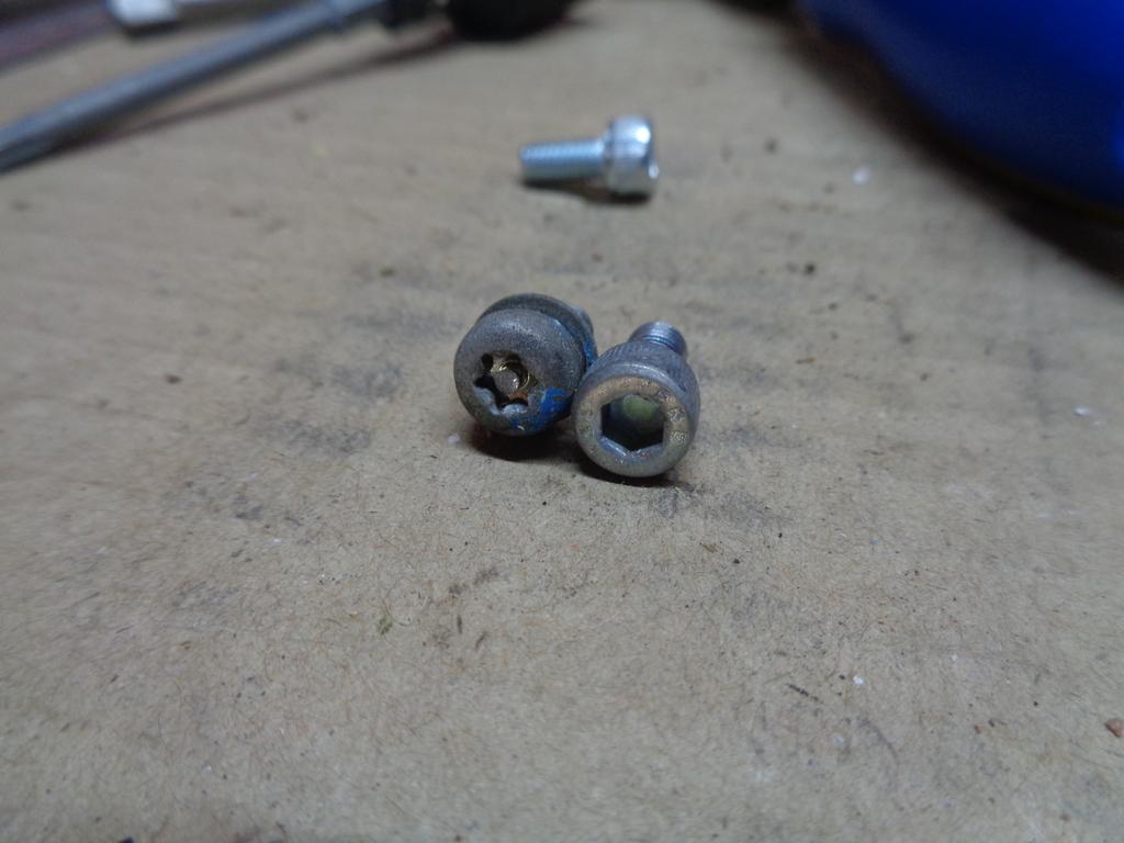

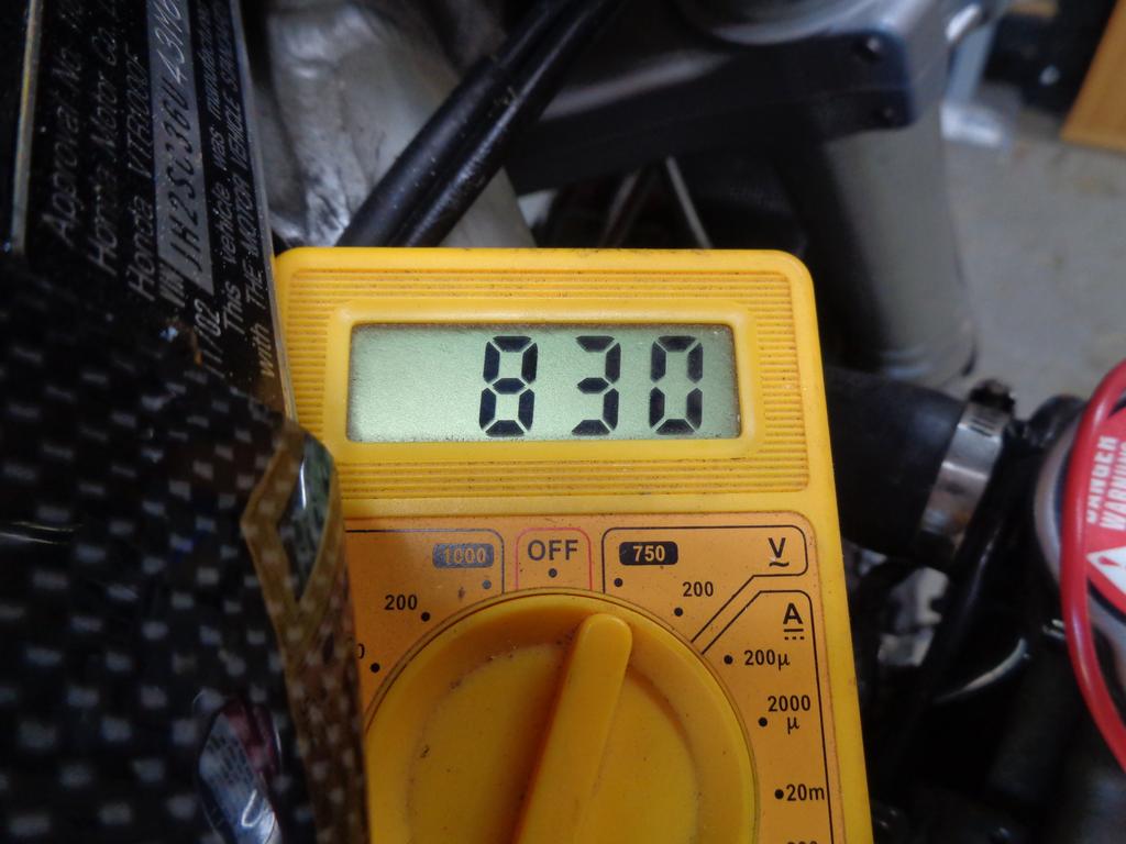

Then onto the TPS,
Attachment 32539
removed the security Torx bolts and replaced with Allen head bolts,
Attachment 32540

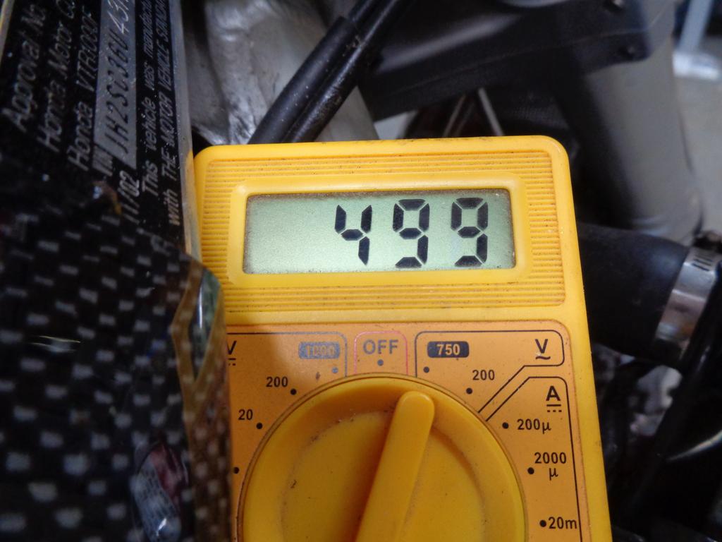

got out the multimeter and connected to the top and middle pins,
Attachment 32541
had a reading of 830,
Attachment 32542
adjusted the TPS anticlockwise until I got as close to 500 as I could,
Attachment 32543

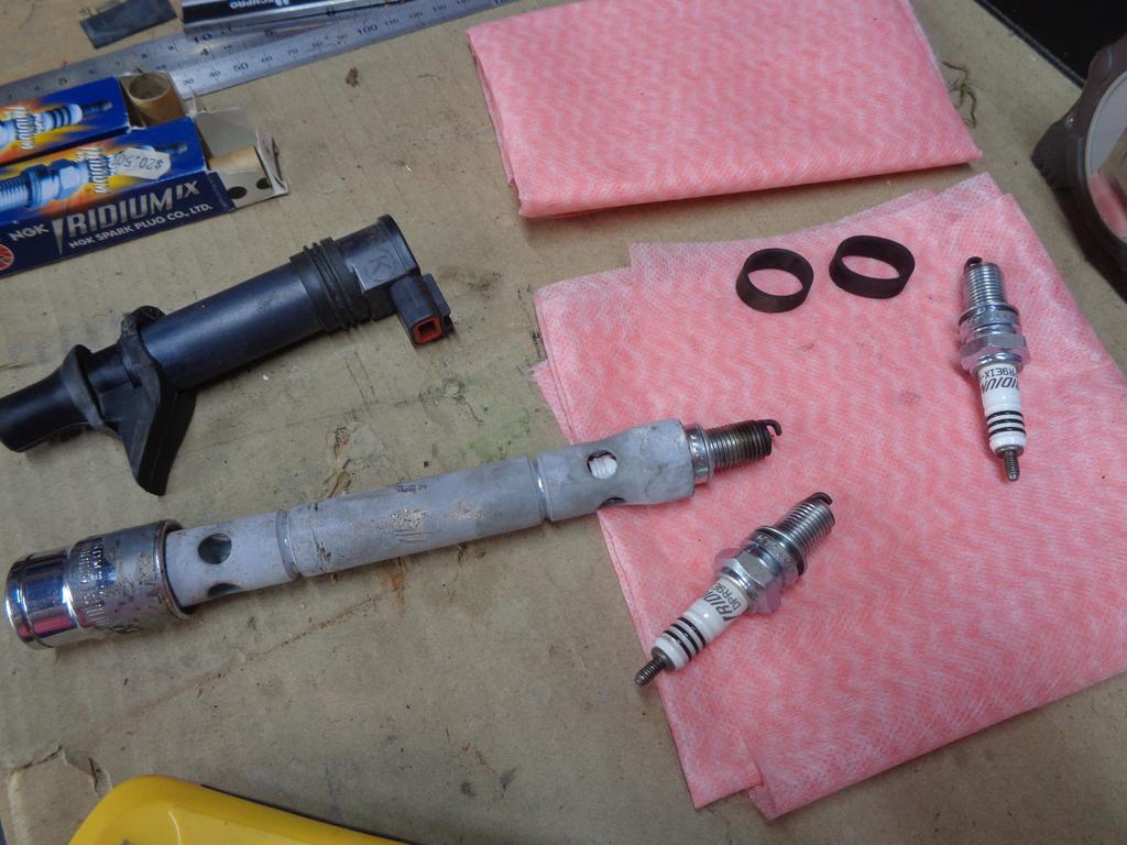

Pulled the spark plugs while I was at it, didn't have new ones on hand, but did have an old set that I cleaned with some carb cleaner and put those in until I get some new ones that will go in with the new filters,
rear plug seems dirtier that the front plug, but the cleaned up plugs should be better than the dirty plugs I'm thinking !? :popcorn:
rear plug with cleaned up old plug,
Attachment 32536
front plug with cleaned up old plug,
Attachment 32537

hondavtr1000sp2 Dec 30, 2022 11:31 PM
Been for three decent rides,
Carb cough has basically gone, did it once on the first ride and hasn't done it since,
hasn't stalled once so far, touch wood :rolleyes: ,
TPS adjustment is amazing, bike is running so much better, smoother, feels like more power, bike wants to lift the front with harder acceleration,
so I'm hoping this has fixed my problems, and maybe helps some one else having similar issues, possibly try some of the things I tried, adjust your TPS, check carb filters.
