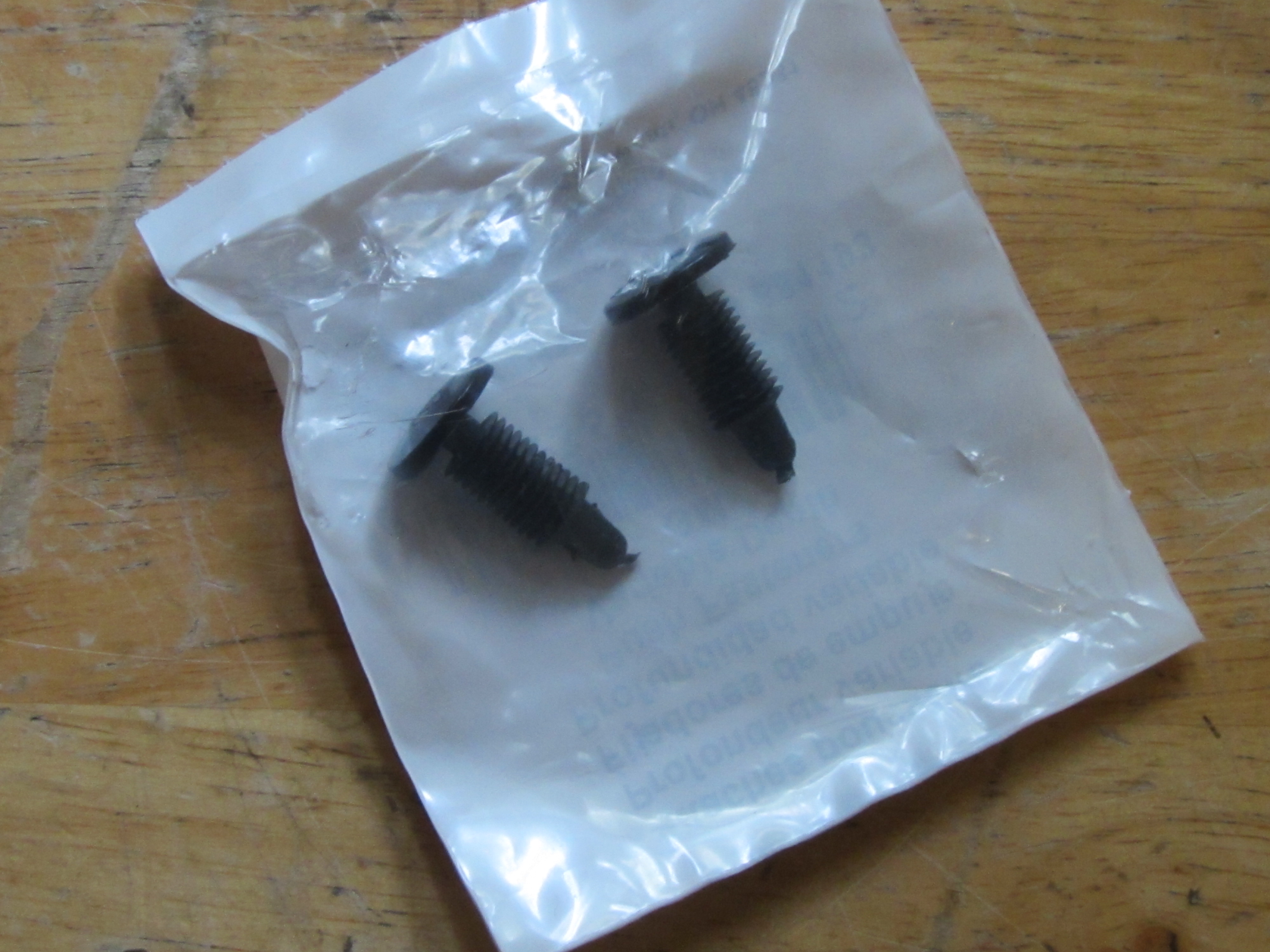

As I was exploring my new to me VTR I noticed two attachment points on the underside of the seat cowl that were missing fasteners. My quick fix was a couple of automobile push rivets. I thought I would share in case someone needed a temporary solution. These were in the Lowes specialty fastener section. By the way, what is the correct fastener that goes here?

Two each of:
NUT, COWL SETTING (5MM)
90111-KW3-003
CLIP, BODY COVER
90683-GR1-003
...assuming one still has two viable mount tabs.
Did the same thing when I rebuild my rear end this year. Wasn't patient enough to find the stock hardware. It's been holding tight ever since.

Thanks VTR1000F for the part numbers.
