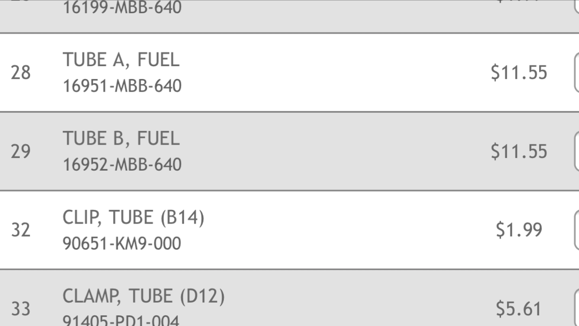

On cheapcycleparts.com (you can get these at any Honda dealer or online oem parts source...
James

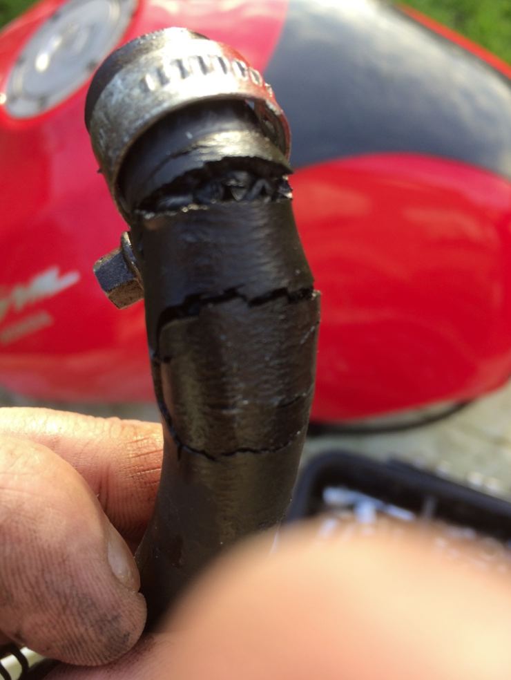

I used for a while aftermarket fuel hose but returned to OEM after it split due to the tight bends where it connects on the fuel tap.
James
Thank you!
