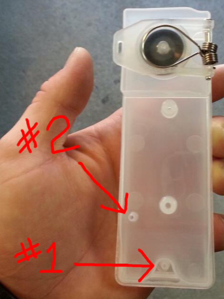

As for filling it, once it is pushed back the 3/4"-1", you can fill it when the tank is up. Otherwise, just remove one easily accessible screw and you can pull the coolant bottle out, do what you need to, and then screw it back in.
Since I've owned my bike, I have checked the level many times, but have never needed to top it off. So, I see this as not that big of deal. As Jerry stated, checking the fluid level is easy. Just bend your knees and take a look.
I know this Traxxas part and attaching it underneath the airbox is not as simple as Lloydie's HRC bottle, but it is another option we have now. Cost? $16 for the Traxxas fuel tank, a couple bucks for a chunk of aluminum for the bracket, and a couple bucks for new lines (also need a reducer, since the coolant expansion line is a larger diameter than the nipple on the Traxxas fuel tank).
#1 is the where the coolant expansion line attaches.
#2 is the vent/overflow

Ok so the replacement bottle just needs a nipple at the bottom submerged in coolant right?
I have a plastic bottle I think will work or I can get one of crux's 3 ebay items. Not much in the way of hobby shops around me.

To fill this Traxxas part, you can just lower it by removing one screw.
As for more mounting location ideas, you can install a coolant bottle inside the black ram air duct thingy on the inside of our fairings. That might work.
Here's a picture of it all hooked up. I never got around to making a longer bracket yet. I have to buy some different lines. Right now it's hooked up with plain 'ol vaccuum lines.

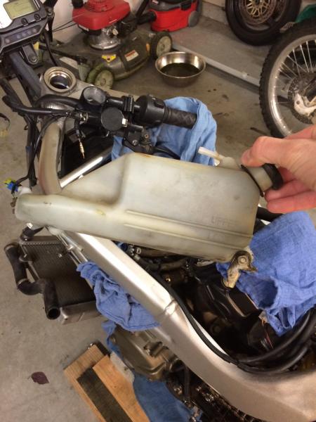

I removed this thing this morning... (Looks like it's on to the For Sale section)
Anyone have the HRC part number on the coolant bottle? I want to look it up at my local dealer.
James

Wow, you had to take a lot of parts off to get the bottle out......

LOL..... Yes, it was imperative the forks come of to get to the bottle. The front wheel and brake calipers were in the way.
Just kidding of course
I'm in the middle of removing the frame for powdercoating.
