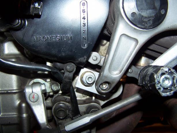

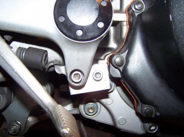

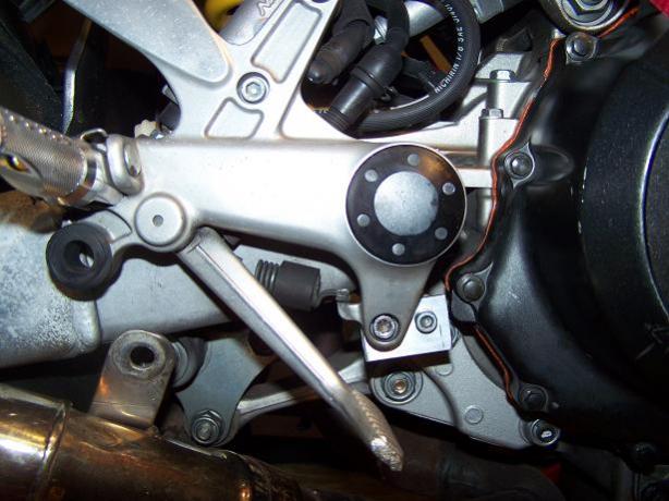

My rearsets only cost me 2 bucks and a little time. I got a piece of 1x1/8 stock aluminum from Lowes, cut off a 1 1/2 inch piece, drilled holes in each end, then removed the lower bolt from the stock pegs, swung the entire setup to the rear a little bit, then used the piece of aluminum as a spacer. This effectively moved my footpegs back and up about 1 inch each. Why spend big bucks when a few dollars and a little time is all it takes.

picture of both sides.....

yeah. thanks for the acknowledgement and i learned it from another forum, another honda, and it sets your feet essentially even with the top of the swingarm> so about an inch rearward and an 1.5" upward. What's really good is it costs nothing and is easily reversible if you decide you don't like it. A win win IMO. Just be sure you to drill the pieces that move it rearward the same so both sides will be equal. I love em and if you drag these, you will be horizontal shortly thereafter. Adjustables may give you more options, i guess.
