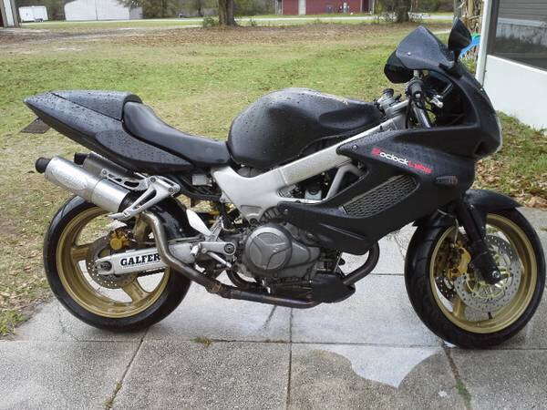

How do you post pictures I have about 3 pictures I can put up
Old Mar 25, 2014 | 08:25 AM
Best way is to upload them to a photo site like photobucket.com, and then paste the image link. Then they're all big and cool looking.

image_zps23c4c2ea.jpg Photo by Rcl0753 | Photobucket
Old Mar 25, 2014 | 08:53 AM
Rcl0753's Avatar
Joined: Mar 2014
Posts: 5
Rcl0753 is on a distinguished road

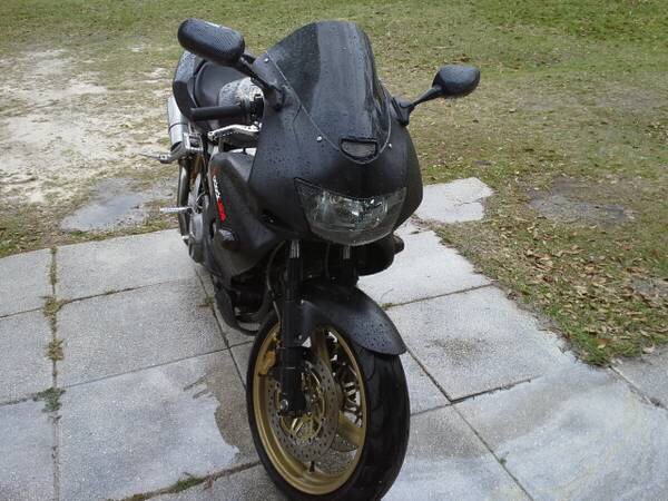

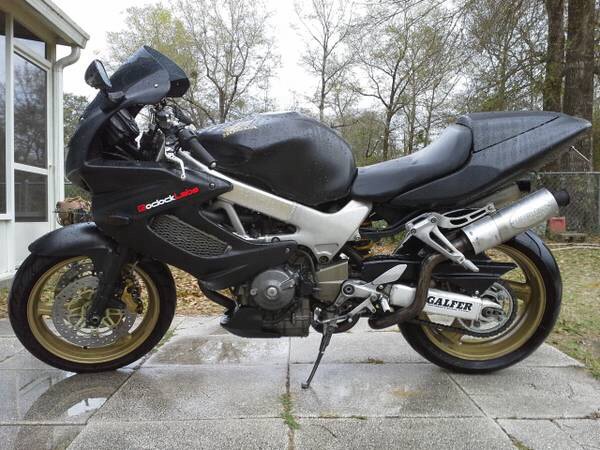

Ok I just loaded the pictures let me know what y'all think
Old Mar 25, 2014 | 10:23 AM
Just so you know, all 1998 Superhawks were red in color. Do you know why it was changed to black?
Also, the wheels and sprocket cover are from a late model Superhawk or someone simply just changed the color.
The subframe is painted black (stock is silver), so you know that was removed at least once. Not that it's an issue. Just an observation.
Looks like a decent bike. Find out why the color change on several parts. Was it dumped? Owner simply wanted a different color, ect.?

All 98's were red, so that one's been re-painted at some point. Looks tasty though!

It's all there, has nice exhaust, stainless brake lines, decent tires, flush mount front turn signals, fender is gone all ready 1500 is probably what you would get for it as a trade on a brand new bike so not a bad price IMO.:-)
