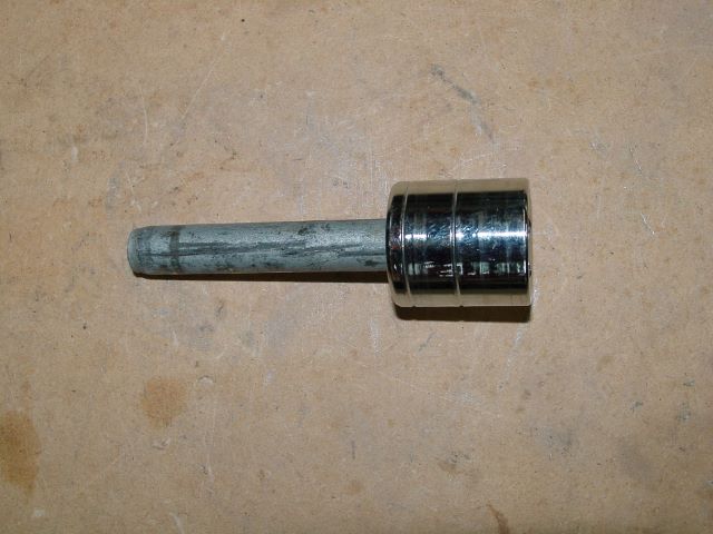

xeris 06-04-2014 06:34 AM
5 Attachment(s)
Thought I'd continue to use this thread for an update on my search for a stand.
The Abba stand looked like the one that would do what I needed. After searching for info on the Abba stand I came to the conclusion that it would not accomplish what I needed as the primary purpose for the stand. That is the ability to remove the swing arm with the bike on the stand. I found this thread www.vtr1000.org • View topic - Home made ABBA type paddock stand dimensions and pics
Attachment 17151
Attachment 17152
The first time I looked at this thread it had some other photos in it, but they seem to be gone now. I saved the page as I originally found it.
Seemed like this stand would do what I wanted, so went about building myself a copy. Already had the welder, but like most of my project there was pre-project work to be done which was wiring the 50AMP receptacle first.
Made a few changes, mostly to compensate for my very poor welding skills and the lack of choices in raw materials.
The 2" tube was thinner than I wanted to use, about 1/16", so I added a bushing (1"X3/4"X2") where the threaded rod and the socket rod (I used a piece of tubing instead of rod stock) go through the vertical legs. Also added a diagonal brace to the legs to prevent excess spreading and cracked welds.
My skill improved a bit as I got more time in. Really had a learning curve with being able to see what I was doing which I think was directly related the other, bigger learning issue which was getting the welder set for the material I was working with. Anyway here is the result. I still need to make a handle. As I said sourcing the right raw material has really been the hardest part of this project.
Going to test lift the bike this morning and if I don't drop the bike I will post a photo on the stand.
The best part (for me) is that I can now install the Fox TC shock that has been waiting for about 5 months.
Attachment 17153Attachment 17154Attachment 17155

xeris 06-07-2014 10:12 AM
1 Attachment(s)
Except for adding a handle and paint the stand is done. Works well, lifts easily, and is very stable once up.
I may make another one (someday) with the screw side leg adjustable like the real Abba stand.
Will most likely still get a regular paddock stand for quick chain maintenance as this stand is a bit fussy to use.
