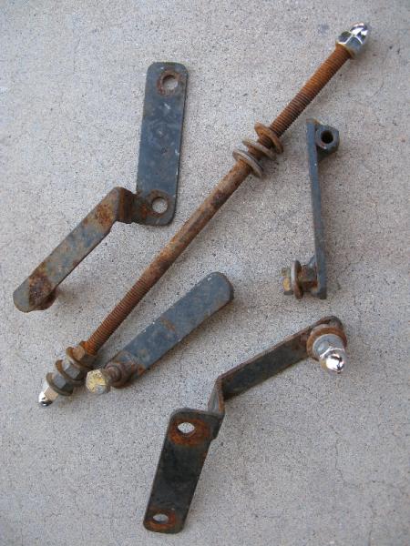

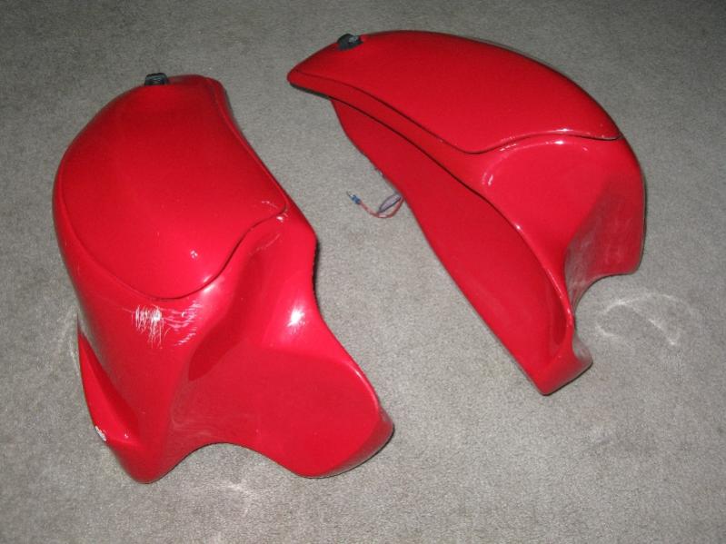

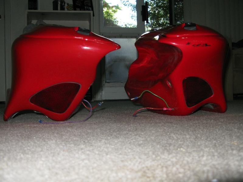

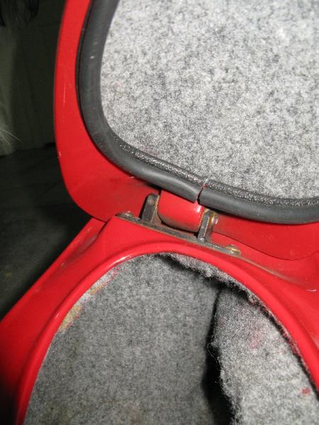

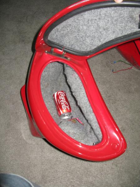

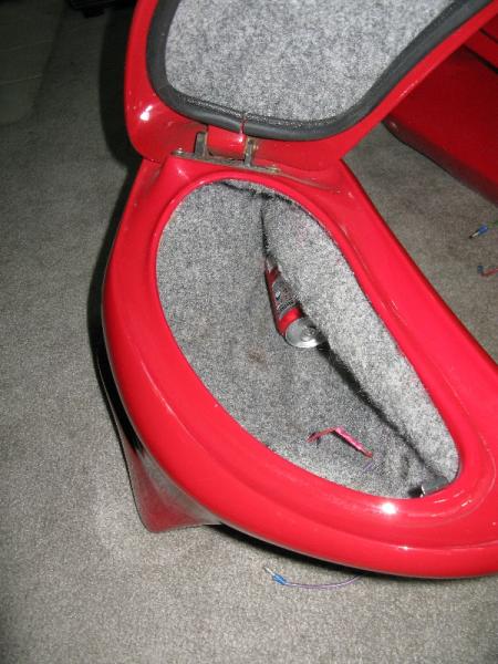

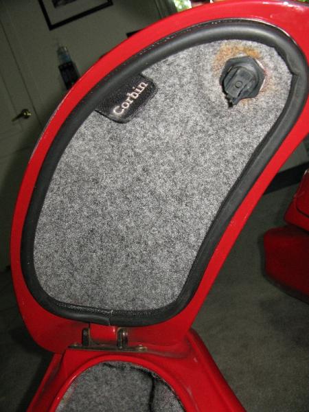

Just got my set of Corbin Beetle Bags off eBay. Looks like they were a set that were on the forum a few years back. I thought I would post some pics for those who have never seen them as I sure as had a heck of a time finding any.

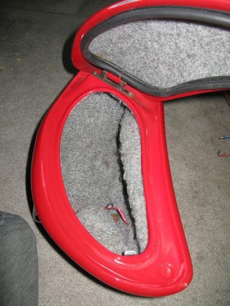

They are actually in really great condition. The right one has a little rash that appears to have only gouged the gel coat. The left one had some of the fiberglass pulled out from the mounting point.
I was glad to see how sturdy these things feel. Great strong hinges for the lids. They are carpeted inside with that speaker box kinda carpet.
The locks dont have keys but I was able to find the manufacturer and a local distributer that sells the entire lock and key for 12 bucks. They are made by southco part number is 93-303. Here is the link to the part if anyone ever needs it.
http://www.southco.com/products/93-k...es/93-303.html

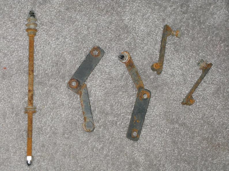

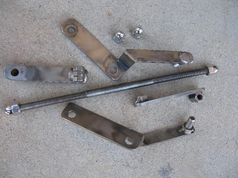

The mounting brackets appear to be home made but they could have come like that from corbin. I will be cleaning those up today and probably powder coating them.
I am throwing around a few ideas I may want to do with them. Debating if I want to do an LED retrofit on them, clean up the scratches and have them painted, make a quick release system for the brackets, put small LED's inside so you can see in them at night.
I only plan on using them for longer rides and will be taking them off when in town.
I have emailed corbin twice now to see if they can provide the installation instructions in PDF but now response from them. Even though they are no longer made they could at least reply.
I put a coke in one bag for size comparison. I was surprised at how much room these things actually have, I may have to measure the volume to see what kind of range I would get out of the bike if I were to convert them to aux fuel tanks lol.
Attached Thumbnails Pics - Corbin Beetle Bags-bikes004.jpg   Pics - Corbin Beetle Bags-bikes010.jpg   Pics - Corbin Beetle Bags-bikes013.jpg   Pics - Corbin Beetle Bags-bikes014.jpg

Attached Thumbnails Pics - Corbin Beetle Bags-bikes016.jpg   Pics - Corbin Beetle Bags-bikes018.jpg   Pics - Corbin Beetle Bags-bikes020.jpg   Pics - Corbin Beetle Bags-bikes022.jpg

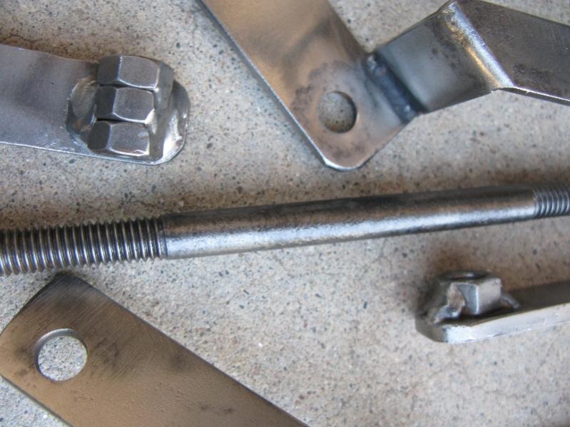

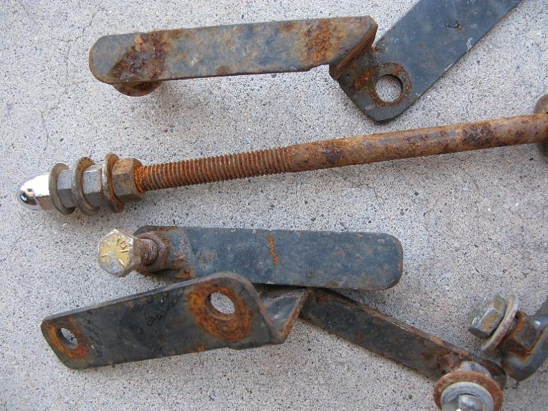

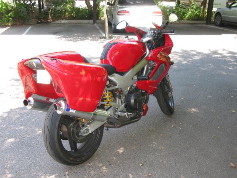

Well things went a lot better than planned, Lazn and I had them mounted almost 10 days ago now. I cleaned up the hardware by using a grinding wheel with a wire brush attachment. Only took about 30 minutes. Made a trip to the hardware store to pic up new nuts, a few bolts and some washers. Since the bags are supposed to use stock turn signal mounts(and I cut mine off) we mounted up some small eye bolts to the undertail behind the plate that the main bar between the two bags fits through then put nuts on each side of the eye bolts.
Mounting them did take a few hours as there were minor movements we needed to make to ensure the gap between the bags and the bike were even. The part that is missing some material on the one bag still had plenty of material and seemed strong enough. We just used a 2 inch washer on the inside of the bag to help hold it together. They feel rock solid and from what Lazn said while riding behind me it looked like they were good while going over bumps.
It was a dry mount we were going to do then I would have the brackets powder coated but since the mounting took so long, I dont think these things will be coming off for a while.
I will post some pics of them mounted when I get a chance.

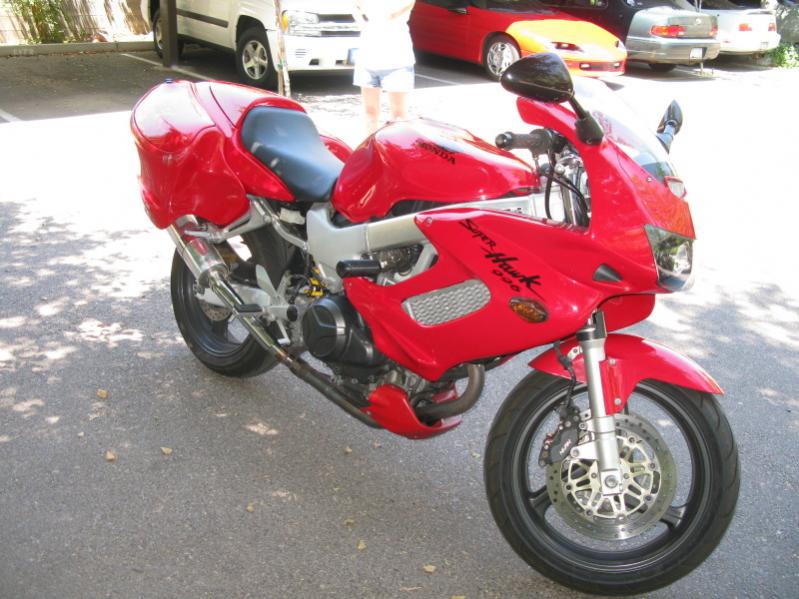

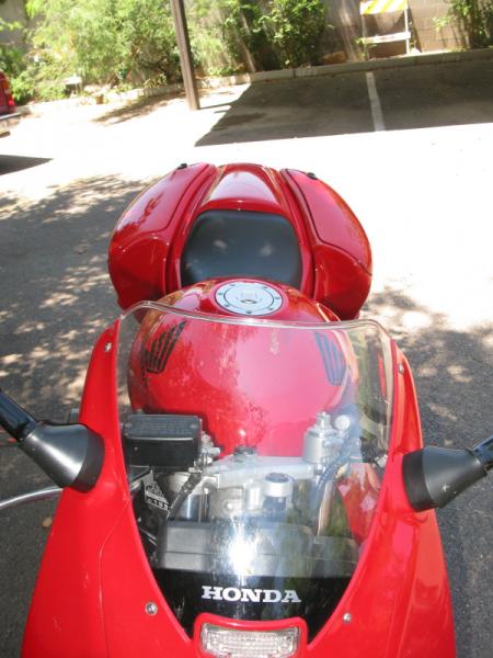

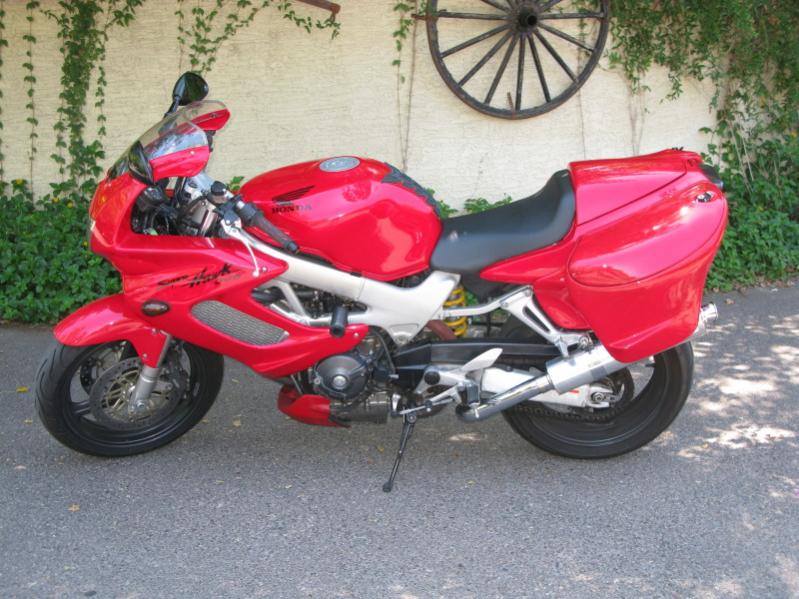

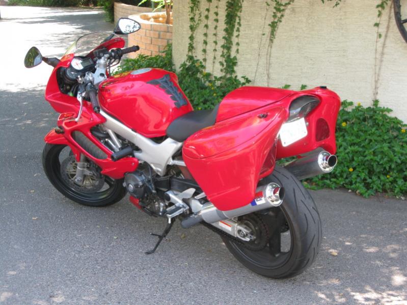

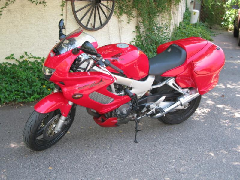

I finally got a chance to take some pics so everyone can see what they look like mounted.
Attached Thumbnails Pics - Corbin Beetle Bags-img_7682.jpg   Pics - Corbin Beetle Bags-img_7683.jpg   Pics - Corbin Beetle Bags-img_7684.jpg   Pics - Corbin Beetle Bags-img_7685.jpg

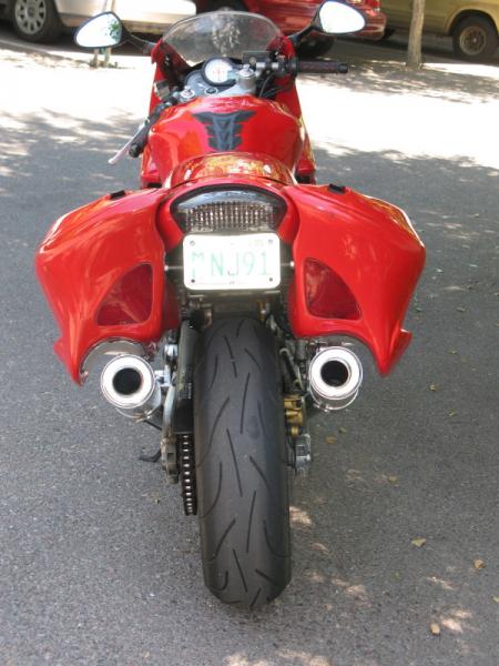

and a few more pics
Attached Thumbnails Pics - Corbin Beetle Bags-img_7686.jpg   Pics - Corbin Beetle Bags-img_7687.jpg   Pics - Corbin Beetle Bags-img_7688.jpg   Pics - Corbin Beetle Bags-img_7695.jpg

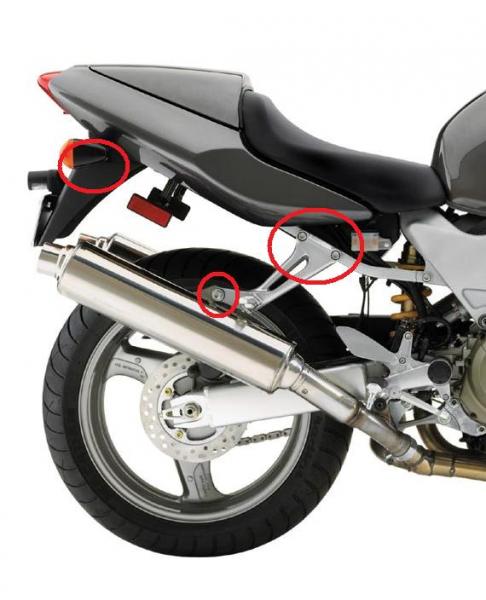

What exactly are they mounted to?
Old Jun 21, 2009 | 08:08 PM
yruyur's Avatar
Joined: Dec 2008
Posts: 507
From: Arizona
Easiest way to describe it was to supply a picture. The brackets mount on the two front circles. The rear mount is a double sided long bold that is supposed to go through the original turn signal mounts and goes into each bag. Since I cut the mud flap off and have an integrated rear light I purchased some eye bolts that are mounted into the pan under the seat right behind the license plate. This way I was able to match the original mounting location on the rear even though the bike no longer has those parts. I have run them a few 100 miles and they are rock solid. I have bottles of water, tools and clothes in them and they dont move around a bit. With the three mounting points you can tweak around with each one until you get all the lines parallel and nothing rubs. Very well designed by Corbin.
