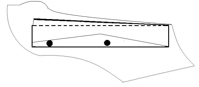

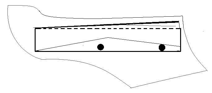

So heres what I came up with. A few issues to be addressed are:
1. When the front or rear of the seat rises, the material needs to move with the foam. The first and easiest way I can see to remedy this is to incorporate a section of elastic material in those areas. If youre like me, you like a more refined finish. The way I would do it would be to leave the sections that lift a little loose with extra material that can be trained to fold into the creases when closed, much like the BMW seats here:
The front section under your knees moves forwards and backwards. When extended, the section pulls on one side of a piece of leather, and the other side is attached to the seat, closing the gap.
2. The idea I came up with would lift a plastic base that covers the seating area of the seat. When one side is lifted, it lifts up the foam. The seat itself never moves, its really just pushing the foam around. A fully adjustable seat is possible, well actually a fully adjustable sub frame is possible, but that would take more skills and money than it would be worth.
So my design is a box with a top that moves. This would be part of the seat base, but this section is floating. The top is a smaller rectangle that fits inside of the housing, with the bottom notched to allow adjustment. The rollers could be just steel bar that runs side to side.
The rollers would sit in a ratchet style lock that is cut into the sides of the housing.

Move the rear roller backwards, and the foam is pushed up in the rear
And opposite for the front
