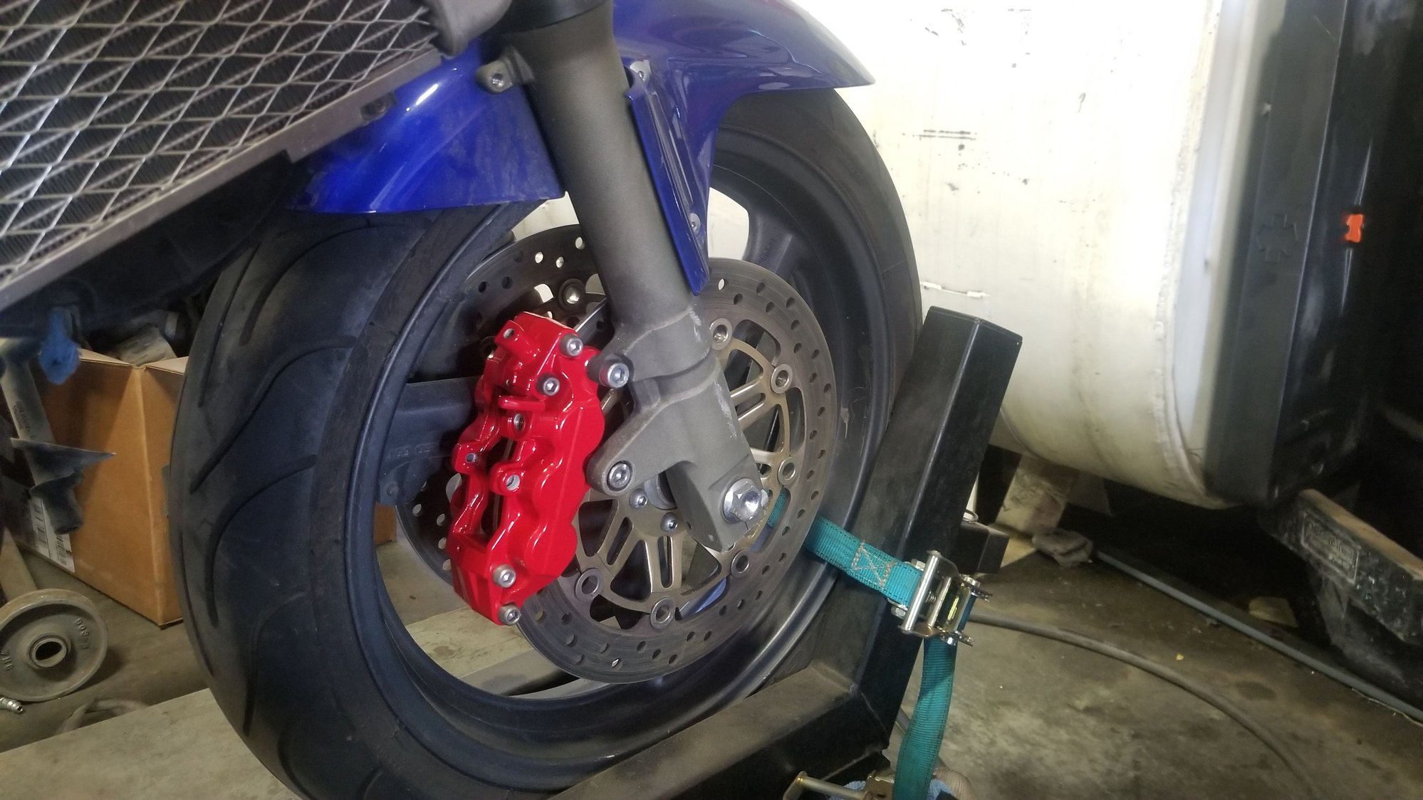

Got some parts back from powder coat yesterday. Thought I'd share this pic.
