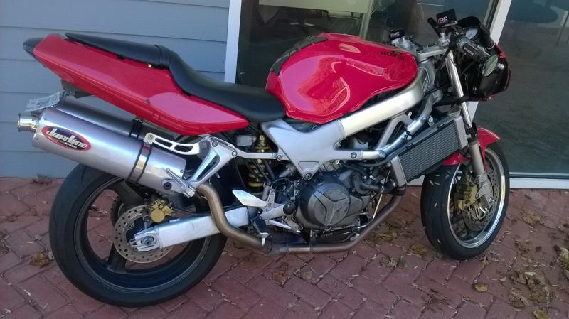

wait... Super Hawks have fairings?
Attached Thumbnails n00b needs pre-purchase inspection checklist-wp_20141111_006.jpg

Yellow? Aw man, did you get some cash knocked off the price for that? You know that stonkin' vtwins should be RED. Yellow, you may as well ride a TL. They were all yellow.
Although, yellow is good for racebikes.
I had a yellow. It took a little trip off the side of a mountain in 2010.
Just picked up a '99 that's been rattle canned black (frame and tank) and has ABS black fairings. I'm gonna start stripping it down and re-working her as my winter project. PO made it sound like it was ridden to church on sundays, but when I went to get it the tire were balled up on the edge like only a track bike can be.
