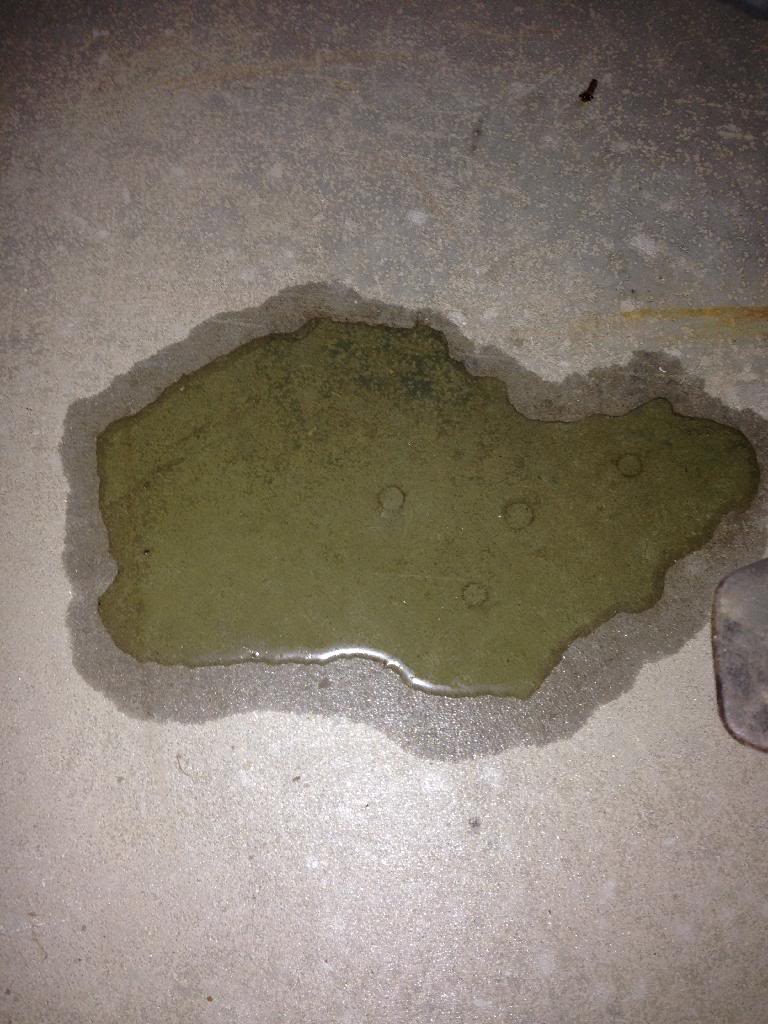

Mysterious fluid
Anyone know what this is and how to fix?

Fixed added photos
Old Dec 8, 2013 | 06:31 PM
Posts: 2,098
Looks like coolant. Water/antifreeze.
Looks like you've got some leaking and running over your stator cover there. The fix depends on where it's leaking from. Can you find the leak?

Coolant for sure, you can tell from the separation lines around, the more purified water penetrated to the concrete floor and the heavier consistency oily substance in the coolant stays on top.

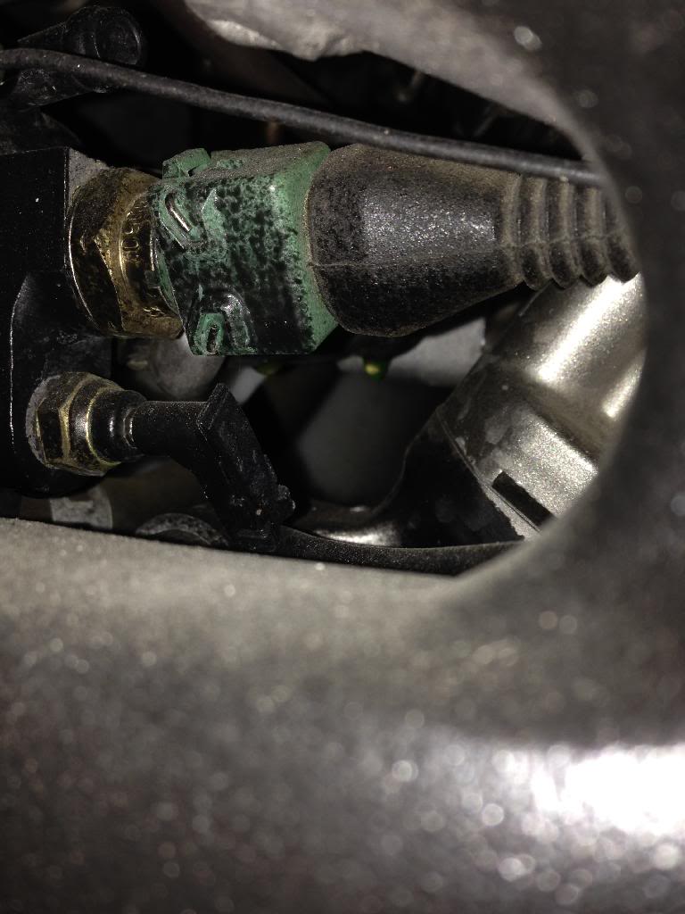

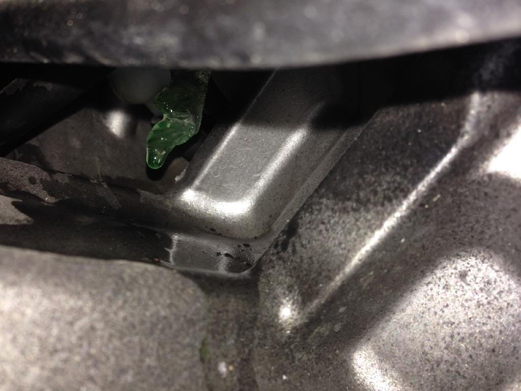

Did a little more looking on it and this is what i found you can see where the liguid starts to freeze and turn to icle.
Is this somehting i need to look into fixing now or later?
This summer after i got the bike back i almost had an overheat issue due to low antifreeze. Wondering where to start looking or if it should wait to warmer weather? I added distilled water after and it ran fine the next few times i rode with no issues. I assumed some antifreeze leaked out with the head replacement and just didn't get back in. So what do you think??? Looking for advice.....

this 1st pic what are we looking at?
what section of the bike.
I cant quite make it out.

It is right in behind the choke
Old Feb 13, 2014 | 06:17 PM
Where is it leaking in the second pick? Almost looks like a drip forming under the top fitting.

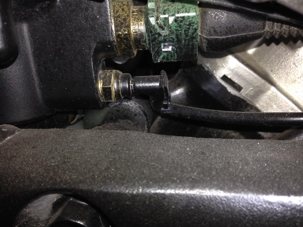

Ok took this pic last night you can see a drip to the back behind the block where the choke is. Is this the link of where coolant flows between the carbs???

That's the thermostat- inside is a valve that opens up when the bike gets warm enough to allow the coolant to flow through the motor. The bottom (temp sensor) fastener does not appear to be tightened all the way. It almost looks like it's dripping on the choke cable and running down that.
That's black over spray on the connectors right? Or is it something else?
looks like a line is missing on thermostat housing!
look at the top!
eta.......may not be used.

Yes the black is overspray. The drip is actually back in the back on a hose coming out behind the thermostat housing.
look at the top!
Just a decoy plug. Not as often does it work it's magic like PVLIR
