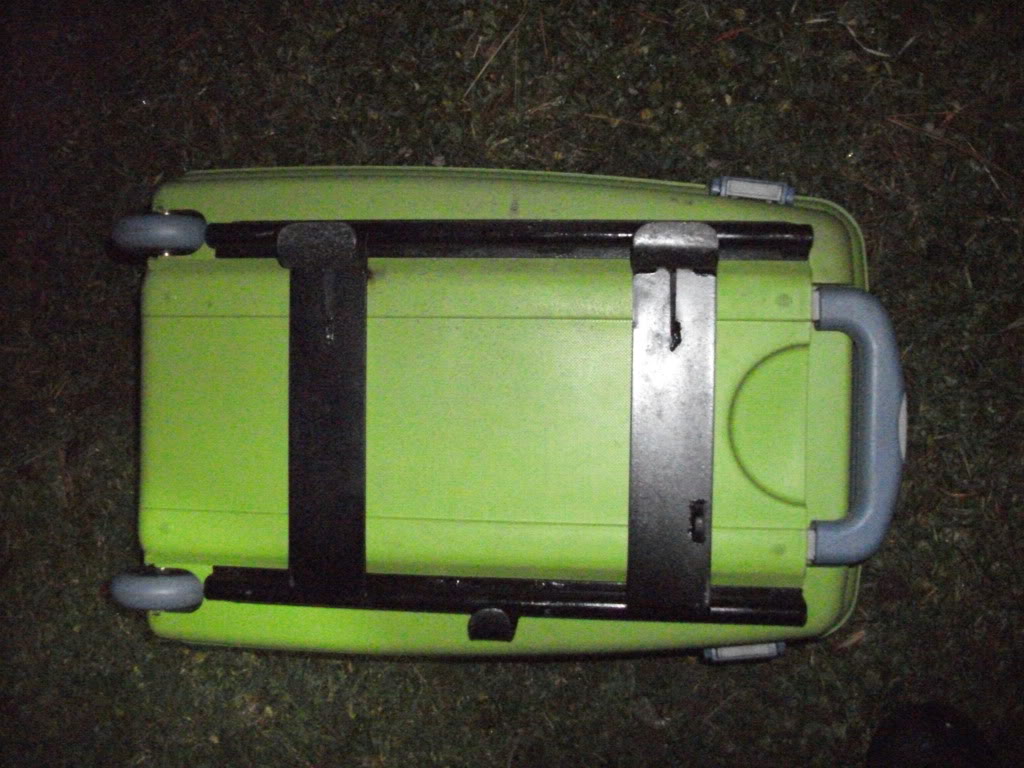

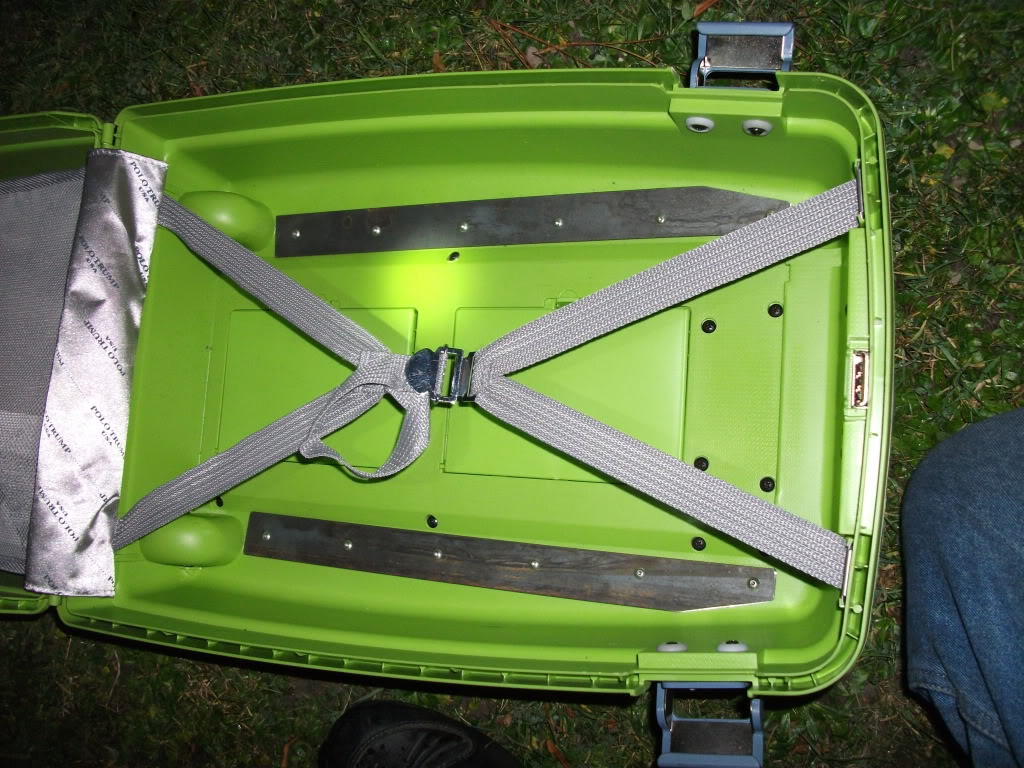

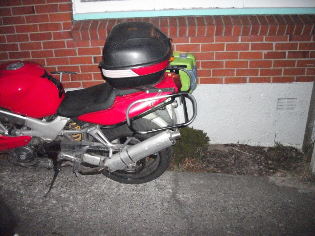

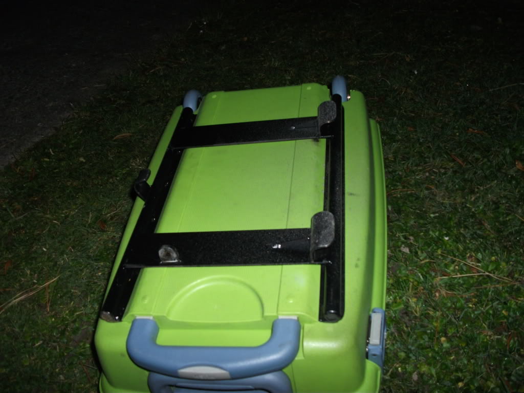

Helloo all.
A while ago I looked into building aluminium panniers. Then work went busy, and I got no further on them.
However, more recently, I found cabin luggage sized plastic suitcase advertised. On inspection, I found them suitable, so I bought a set.

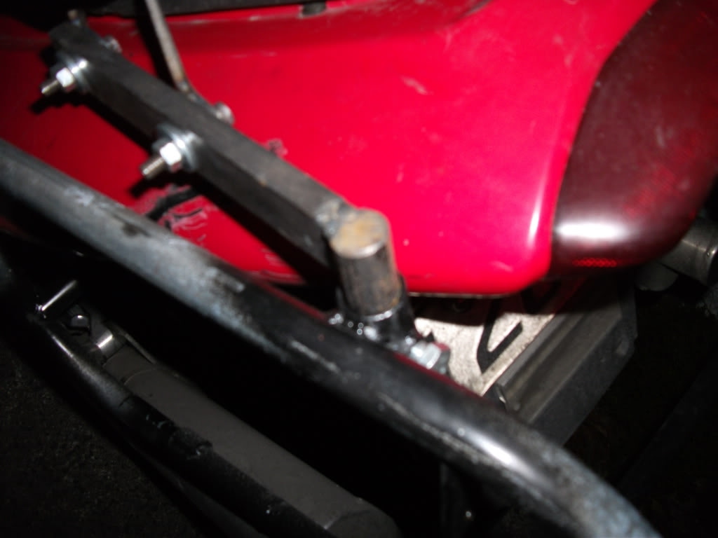

I used a ventura packrack to base my mounts off, and also have a pivoting mount for the topbox, allowing the box to be foward for solo riding, or back for carrying a pillion.
I have yet to make a lock for the topbox pivot arms, so while it can't come off, it does tend to wobble in place.
The panniers can be removed, and will have to be, to be fully loaded, as they hinge at the front, not the bottom.
Oh, and sorry about the horrible colour mismatch...they were on special, and green was the only color they had two of left
Solo:
Two up:
Locking mechanism:
Other pics:

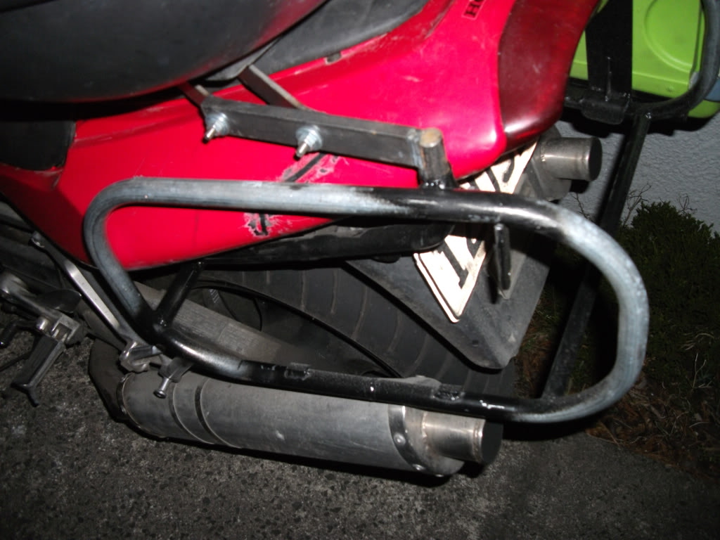

Good idea! Well done, I love seeing creative thinking come to life. Do you have picks of the brackets mounted without the bags?
I would like to follow your lead and fab something similar.

+1 on the creative thinking. Great job.

Fresh paint and a new windscreen and this will be the absolute bomb, sport-tourer of all time!
Great workmanship and innovation!
Carry On,
Gunny

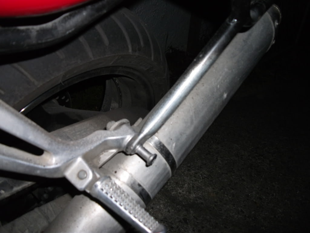

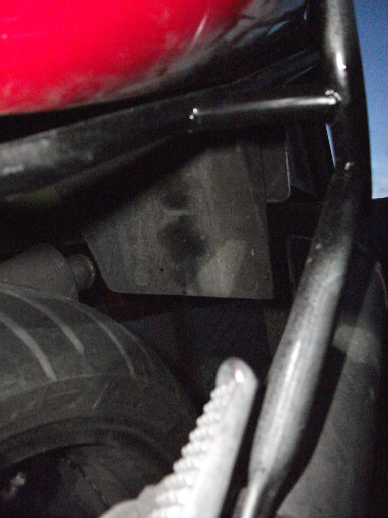

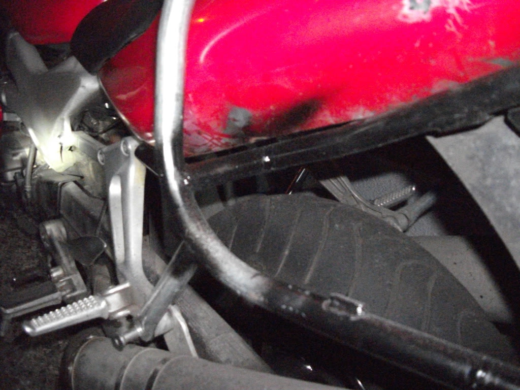

More pics to follow, of panniers off bike, showing the rack and mounting system
Old Jul 20, 2011 | 12:45 AM
Kieran's Avatar
Joined: Aug 2008
Posts: 52
From: Dunedin, New Zealand
Kieran is on a distinguished road
Sorry about the slightly grainy pics- it was at night

Thanks for posting the pics... My mig welder is calling me as the Ventura bars are already on my VTR
