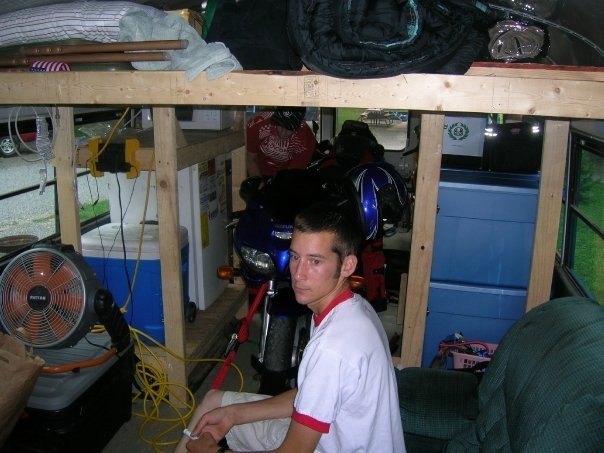

we move them all the time in my bus. I made some wheel chocks and they work great. something like the condor, but I made them with my students. I have extra, but they prob wouldn't ship nice.
