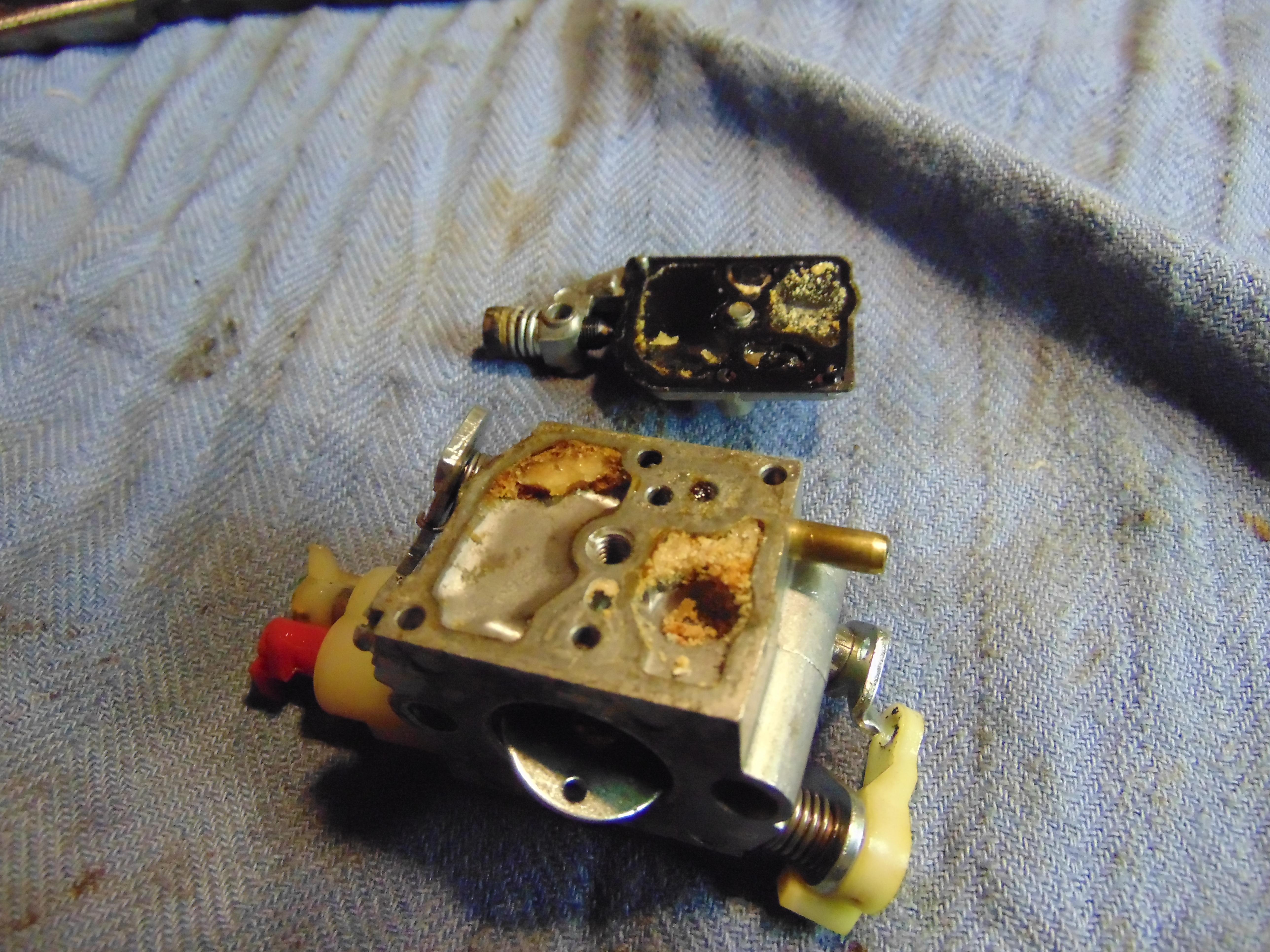

My guess is you have a small bit of ethanol residue in there that needs cleaned out. Sitting is the problem w/ eth. Check out this pic I took of a chainsaw carb I disassembled.
Did it sit in a climate controlled garage?

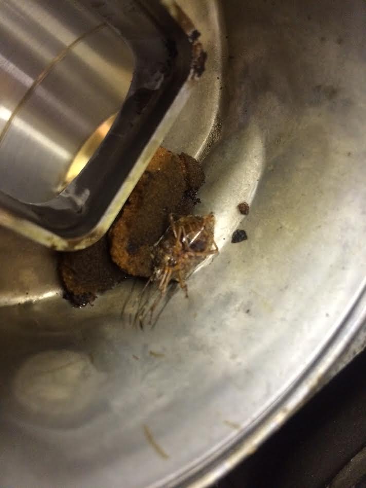

Old Sep 21, 2016 | 07:52 PM
Otto Man's Avatar
Joined: Dec 2006
Posts: 240
From: Jacksonville, NC
Found this when I took the rubber diaphragm off the back carb. Sigh...guess I DO have to pull the carbs.

Finally got a chance to work on it some more. Here's what I found:
ANOTHER stink bug in the diaphragm on the front carb, along with some small pieces of foam filter (From the old mini air filters). Main jet I could see some day light through it, but definitively restricted. The other smaller jet was clogged, but some carb cleaner and help the from the air gun got it back to new. Not a whole lot of varnish in the carb bowl, but some was there. Gave both carbs a thorough cleaning, taking my time on everything. The front carb looked far worse than the rear carb, which matches the spark plug reading (Front was rich, rear looked perfect).
Button it back together...and it won't start. Cranks but no life. I stopped there, as it was late and I had to go to bed. But I was doing some searching on here, and got a plan of attack - verify fuel is coming from the tank.
I couldn't stand it, so I HAD to open the drain valves on the carbs to see if I was getting fuel. I am not. That was literally all I had time for before leaving for work. I searched for the infamous vacuum line on the petcock. I will have to check, and recheck, but I am 95% sure I have it hooked up correctly. Two fuel lines to the sides of the petcock (obvious), the overflow tube (obvious), and the vacuum tube. Mine has a plastic adapter, as the line coming from the tank is smaller than the vacuum tube going to the motor. Because of this adapter, I don't see how I could mis-match the vacuum line, as the line is too small to fit on the bottom of the petcock (isn't this what most people mistakenly hook it up to?)
Either way, at least I know what I am lacking (fuel). Will tackle it more tonight.
