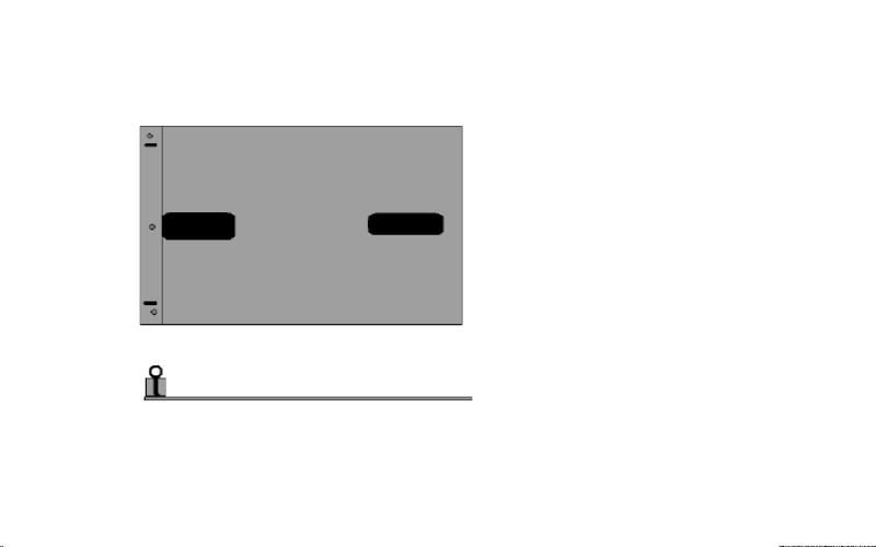

If you use a piece of wood that covers most of the oilpan you should be ok. It'll spread the load instead of trying to poke though the casting.
More importantly, you mentioned that you will use a rear wheel stand in conjunction with the jack. Be careful with that combo because this forms a very narrow triangle which doesn't like torque loads.
The first time I used that method I almost levered the bike on it's side trying to break the front axle nut loose. I would suggest that you either break all the nuts and bolts you have to remove loose first or build yourself a platform like I did so that you can tie the bike down securely.

hey guys, yeah no word yet on what or how cuz i only had enough time to change my rear tire on sunday (i changed the tire myself, and this was on the RC) im waiting until this weekend to do the front tire. hopefully i can get a front stand, but cant say. im planning on jacking from the oil pan. u can clearly see what looks almost obviously like a jack point. i ask mainly about the wood + headers because of my buddies gsxr is obviously an I4, so theres no clearance to the oil pan.
kai, can you explain your diagram a little? ive seen it else where, read the explanation, and it didnt make sense
