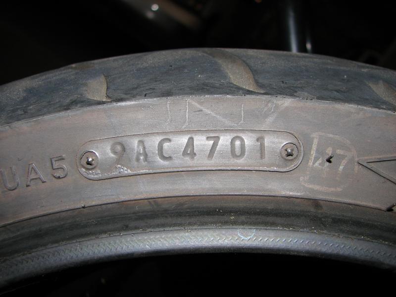

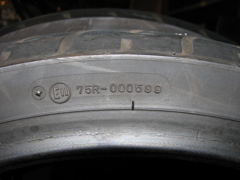

how are the sportmax radial d207's? anyone have any good opinion or experience? i got a set of them with my bike when i bought it last year, and i just dont know much about them. i think they might be old. i took a couple pictures to see if one of you guys knew which one was the date stamp.
from what i know, it seems they're 2001's, but i thought i would make sure. its come time to change the tires on my bike, are these worth using? the tread is like new. thanks everyone.

Yeah, those are old and will probably not have much feel or traction compared to when they were new or to anything fresh/modern.
Personally, I'd throw the rear on if I knew I was going to do a lot of straight up commuting or highway droning and keep the front as an emergency backup spare.

5th wk of 99 & 47th wk of 01, note the brown oxidation

Soneone may have already said this, but that tire was made in the 47th week of 2001. Six & a half years old, so not too fresh. Somewhat depends on how they've been stored & how much sun exposure they've had.
I'd look for surface "checking" on the sides and tread of the tire.
Plus D207 are somewhat old tech.

Just took a closer look at the pics. Just looking at them they look "dry" & brittle. Tires degrade chemically over a fairly short time span. Caution is the word.
