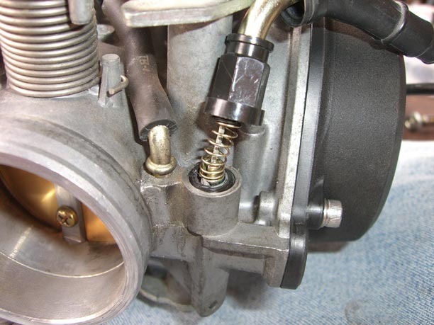

Originally Posted by reaper
When you pull the carbs off be very careful to unscrew the choke needles as the assembly is plastic and will break very easily if one is not careful.
Yeah, it sure doesn't take much to snap the threads off. I'm still waiting for the part to arrive. Glad I fixed it at least temporarily.
Old Jun 30, 2009 | 12:34 PM
Kendrick's Avatar
The Hypno-Toad
Posts: 467
From: Milwaukee, WI
Not to mention it helps to have a small child help reach them for you. Not having one handy, it took me about half and hour to get those things to thread back in.
