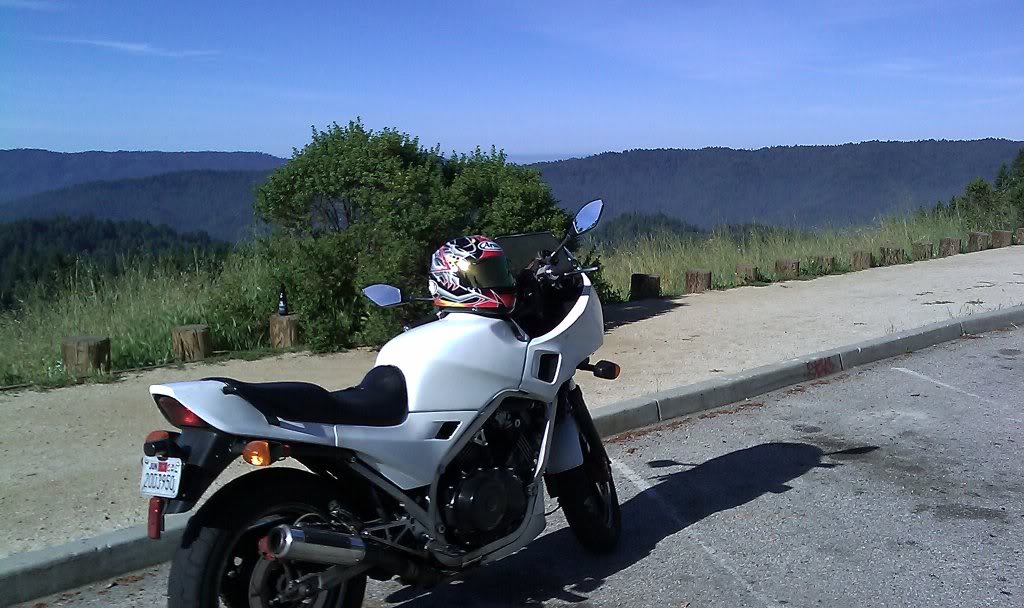

and just for anyone who's interestedName:  IMAG0075.jpg
This is my playground =D
notice the chicken strips on a 600lb bike! BWAHAHAHAHAHA!
