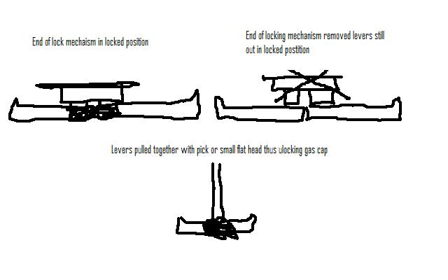

The second (the replacement tank) worked awesome-I drilled out the lock cylinder to the bottom-not all the way through though. I was able to pull out the little thin bit of remaining lock cylinder, and the inner workings of the two little teeth that grab the tank were now exposed. I simply used two of the little pointer tools I have and unlocked it.
That's what worked best for me. The hammer screwdriver wasn't getting it to turn. So I just carefully drilled (about an inch?) down and you will notice the end of the locking mechanism if you take your time and at the end of the lock there is two spring loaded levers that hold the cap down. Simply pull together/pry both of the levers inward and the cap should come unlocked.
(Keep in mind this is happening about an inch down into the gas cap)
+1 to me for awesome MSPaint diagram.
Attached Thumbnails Anyone have experience removing a locked gas cap without a key-gascap.jpg
