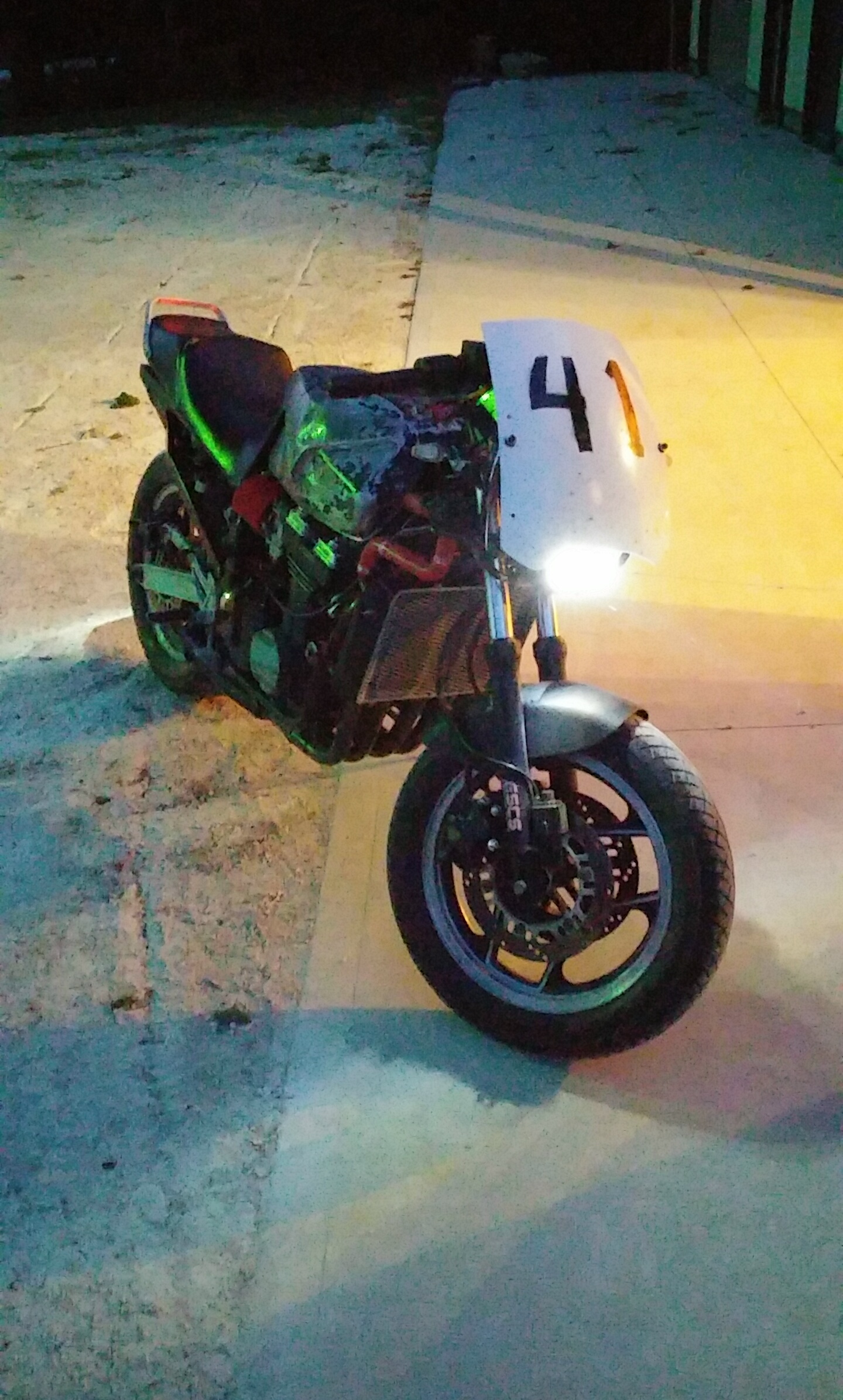

Lots of change over the summer. Lucky for me, I actually had this bike road worthy a day after the superhawk blew up on me so its officially back in business after 15 years of abandonment. Runs decent but far from good. I've got it to a point where it will pull to redline in every gear but there is a good bit of coughing in the last few k's of the top end. Tried going a bit richer on the top end and that made it way worse so in the process of going back down trying to find the honey hole. Starting idling and midrange are all pretty good so its just a matter of finding the right mains and adjusting the needles accordingly. May not be smooth but boy is it a blast to ride. I geared it -1/+2 and shaved over 30 pounds from the factory weight so its agile enough for its age. The seating is very low into the bike so it doesnt flick super fast but it still corners pretty well with the redone suspension. And man oh man does the thing scream. I'm sure I'll get sick of it soon enough but for now I just cant get enough of the bark that this bike makes. Sounds like I'm doing 200 in F1 but the reality is 85 on a ratbike. Almost makes up for being slow. An no tickets yet which is very surprising, my buddies can hear it from about a mile and a half away.
Looks wise, it is still every bit a rat bike. I made a 5 minute front shroud to protect the cluster and have yet to paint the tank and frame. The lights are great though, I built my own dual LED headlight unit that works very well and retrofitted a ducati monster taillight with integrated blinkers to keep the ugly butt tidy. I'll get some better pics up later and update again if I get the tuning closer to where I need it to be.
