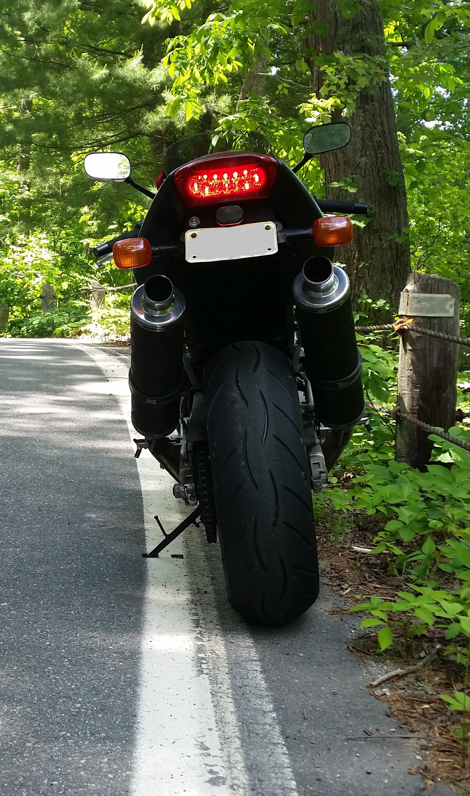

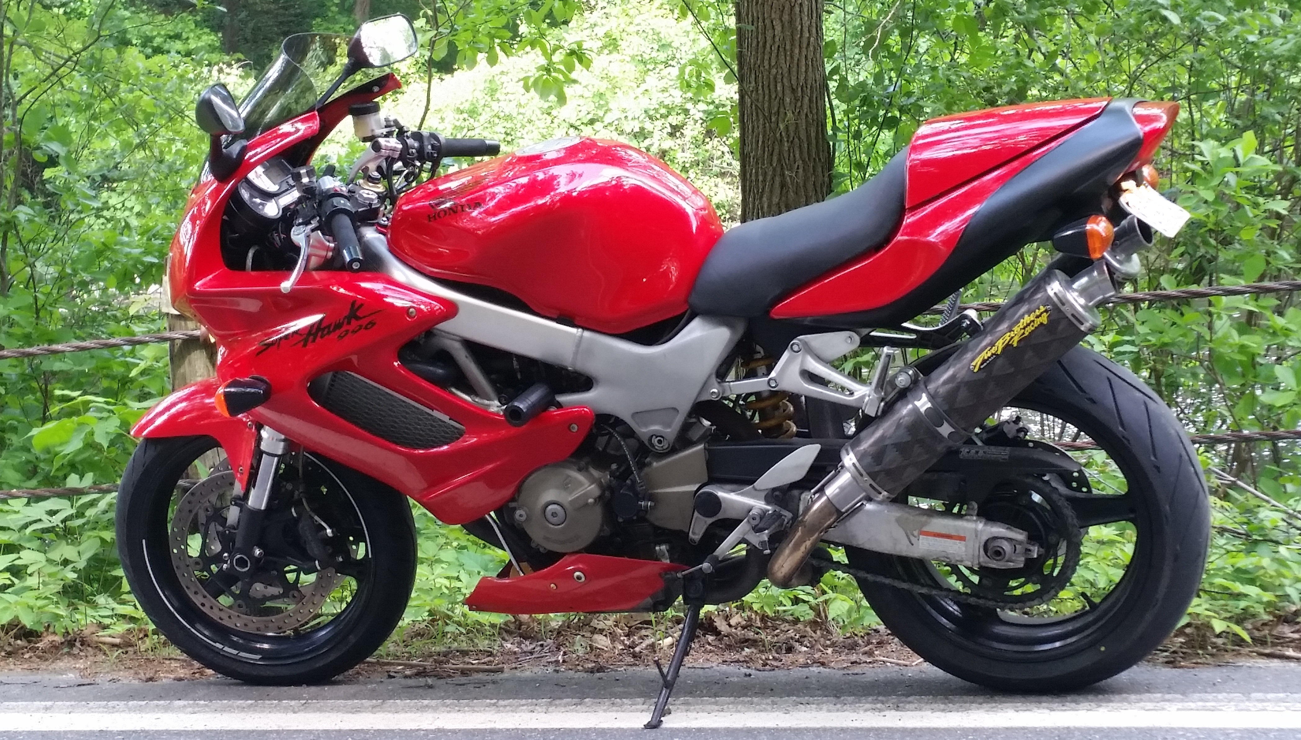

Agree with captainchaos, the two brothers do have a better deeper sound, especially the carbon fibers!!
Now, high mounts are good, but I personally like the swept up look as the RC51, kinda becomes high mount, there for I did it with low mounts, twisting the left side upwards at the connection point and right side clockwise at the connection point as well, with couple brackets I made from aluminum to relocate the rear footpegs, everything falls right into place naturally, it also tacks in the exhaust tips.

That looks great NHSH, nice job. Yeah I do like the deep sound I am getting with the aluminum TB exhaust, I will probably repack them to quiet them just a BIT and look for the high/medium mid pipes. Do you guys know if I absolutely need the Two Brothers higher mid pipes to work with my Two Brothers exhaust or will other brands of higher mid pipes work? I am ok with customizing spacers/extensions for the pass. foot pegs myself, of course it would be nice to find a kit...
