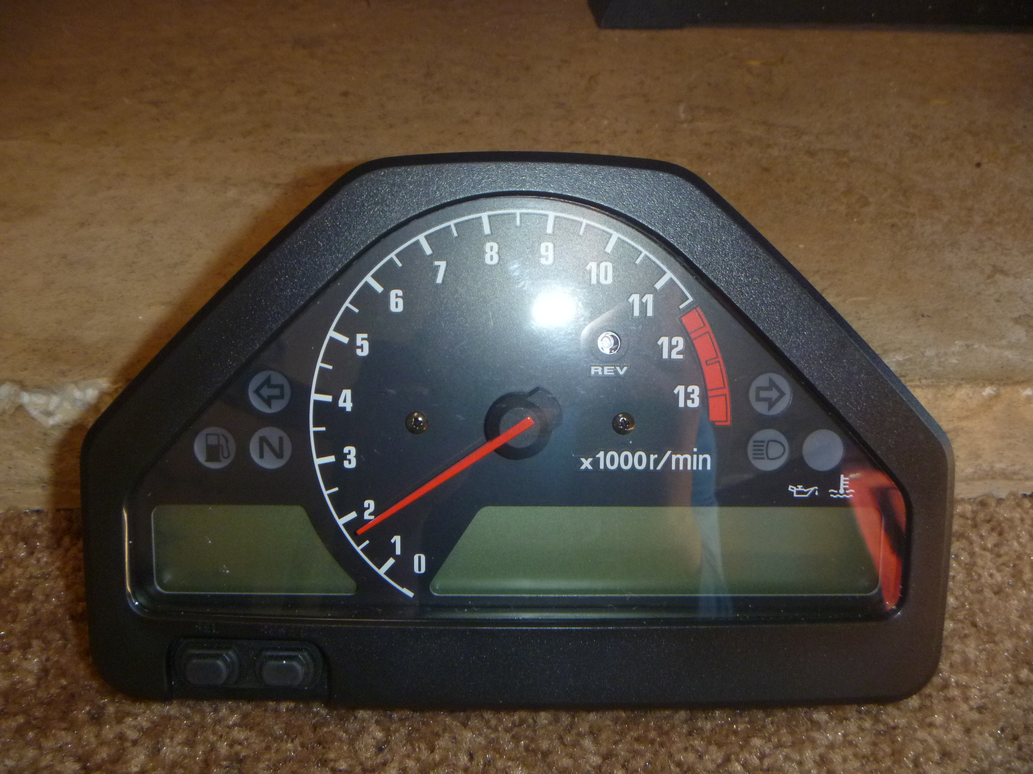

Not sure why they won't on my 919 but oh well. Make me an offer

They'll work, what did you have trouble with?

The tach needle won't return to zero in your first pic?

Thanks for the help guys, the only thing I can get are the background lights and turn signals. Doesn't show any numbers or do a tach sweep.

You have the cbr harness? It should do those functions when it has both the constant power and ground, then the switched ignition on power.
So if you have the plug that went with the bike and have a bunch of wires to connect to you have a better chance than if you try to touch the pins in the connector.
You should get those functions to work without connecting to the bike, just use a 12 volt power supply.
The temp and fuel may use different resistance levels than the bike but that is adaptable too.

I bought an 04-05 harness and and followed the diagrams seen on the other thread here and basically got nothing. Do you think the tach not reading zero has something to do with it?
Old Feb 17, 2017 | 08:12 AM
Off the top of my head I would say yes. Every pic on google and ebay show it returning to zero by default. I would guess a bum (faulty/damaged) unit.
