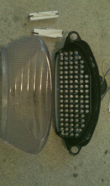

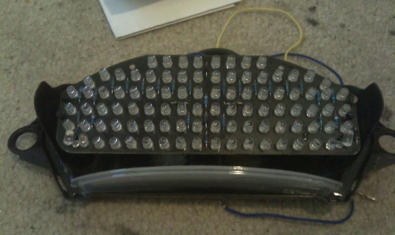

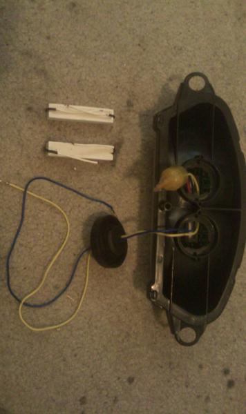

ok,heres the deal,i got fed up trying to get this light to work correctly.
after trying everything,im sure i gotta cut the plug off and rewire,i think the wires are in the wrong location and im not in mood to find or order the plug to do it.i did hook it up straight to battery,it does everything its suppose too,it does work.
plus for where i live,i dont trust the lights,its not bright enough to make me feel comfortable.
there is to many accidents down where i live,for the past 3 months,there is a motorcycle accident every wed and sat,some is death,so if its not bright its not for me.so im done with it.

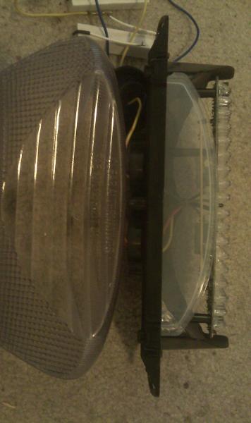

what i did,i took off the smoked lens and put a clear lens on with it,it still has the clear sheild on bottom for the tag light.im gonna do the tail light mod.

To get it to work, all you have to do it put the yellow plug in to one of the rear brake light holders, and connect the resistors inline with the blue and yellow wires, which are then put in to the indicator connectors hat are above the CDI units under the seat.
Piece of ****
