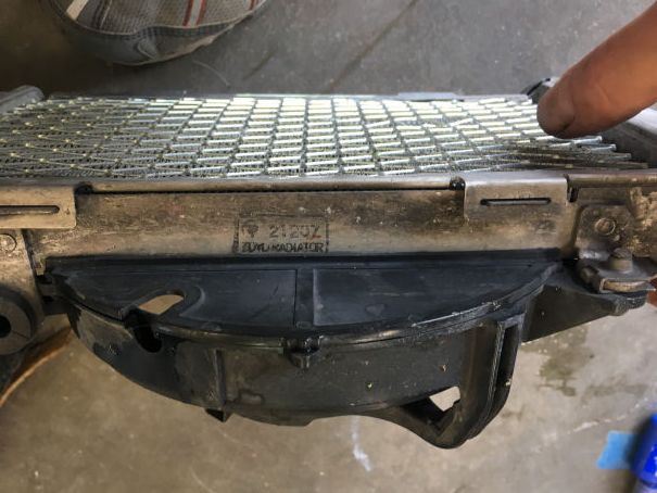

I had read the fan does not fit the mounts....but to make it fit absolutely correct, it’s not as simple as making a bracket, or at least on the ones I got.
The fan shroud is designed to fit flush to the radiator body for an "air tight" fit.. Without modification of the fan and radiator mount, the resulting gap would have compromised air flow though the radiator core.
https://cimg9.ibsrv.net/gimg/www.sup...ee1e55a604.jpg
That simply was not possible with these aftermarket radiators just making an adapter bracket to "move" the mounting holes. I had to alter two of the fan mount tabs and cut off the "L" part of a third. Clearance the fan in a few places, clearance the third tab. Cut a slot in the fan tab so it fit over and locked in place the third mounting point, and then safety wired the third tab to the fan. I now have a fan that fits without distortion; it is flush and sealed to the face of the radiator for maximum air draw though the core. And it is held tight so as to not rub holes in the plastic or aluminum for many miles to come.

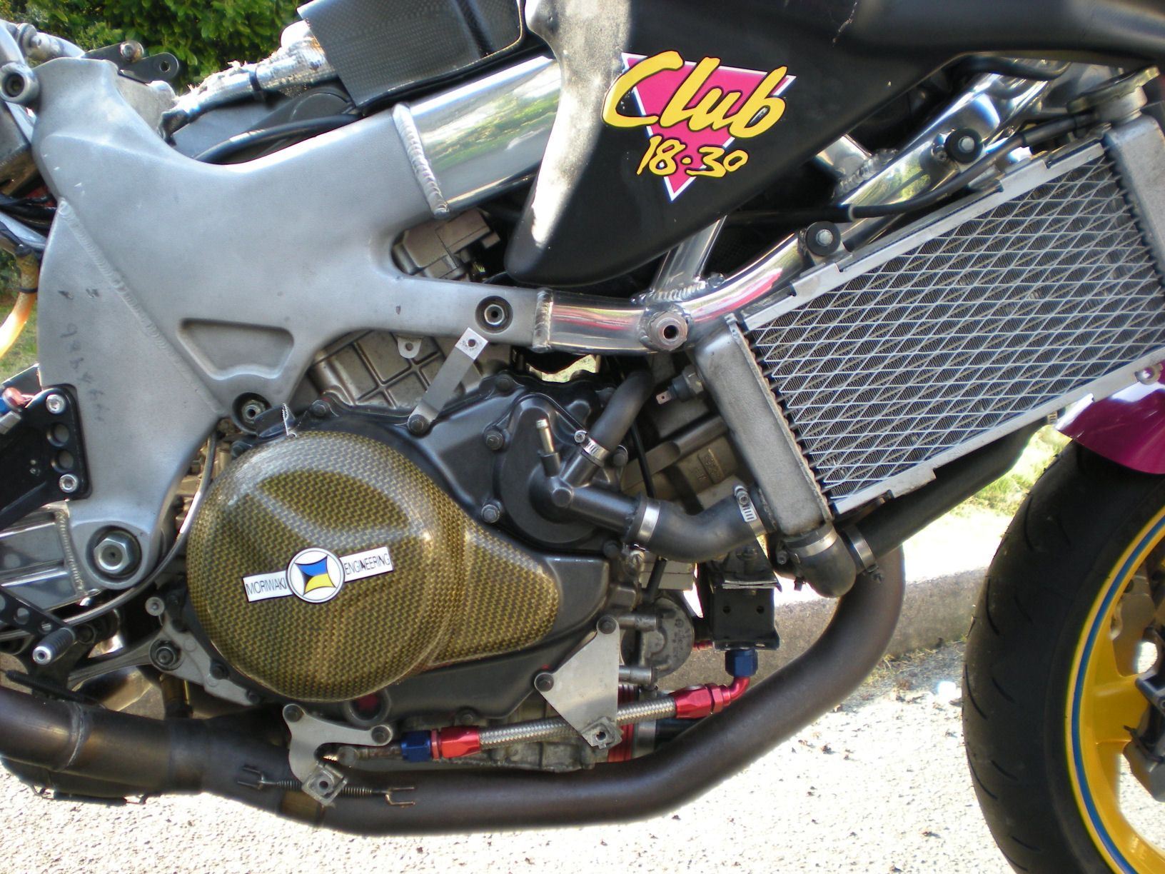

Question I have is, does the Super Hawk have cooling issues with the standard Radiators? I am getting my bike ready for Track Days (Tony's or Fishtail) and would my bike need this for an upgrade, because from what I can see, there is a lot of adjustments that need to be done. From the pictures, one of them shows the bottom radiator hose look's like it is very close to the exhaust, but maybe it is a bad angle perception.

My street going VTR in Texas summer heat, can get to be a cooling concern if I get stuck in traffic..That really is the only time it s a concern.
That said, the over all temps can come down 30deg and Id be happier over all.
At speed (track) I dont think its much of an issue ..
Many folks cite "The Moriwaki Bike" as the standard of "best" not really the ace in my opinion as a lot has been developed since that bike was campaigned, but the point is, it was a great working package proven, and yes probable the best at the time.
So, if it worked on Moriwaki bike it should work for you..
https://cimg8.ibsrv.net/gimg/www.sup...4970e97be4.jpg
Stock VTR rads and the lower hose just tucked in behind the header. And old school rubber hoses at that.
https://cimg7.ibsrv.net/gimg/www.sup...379af744e8.jpg
And the same clearances with mine
