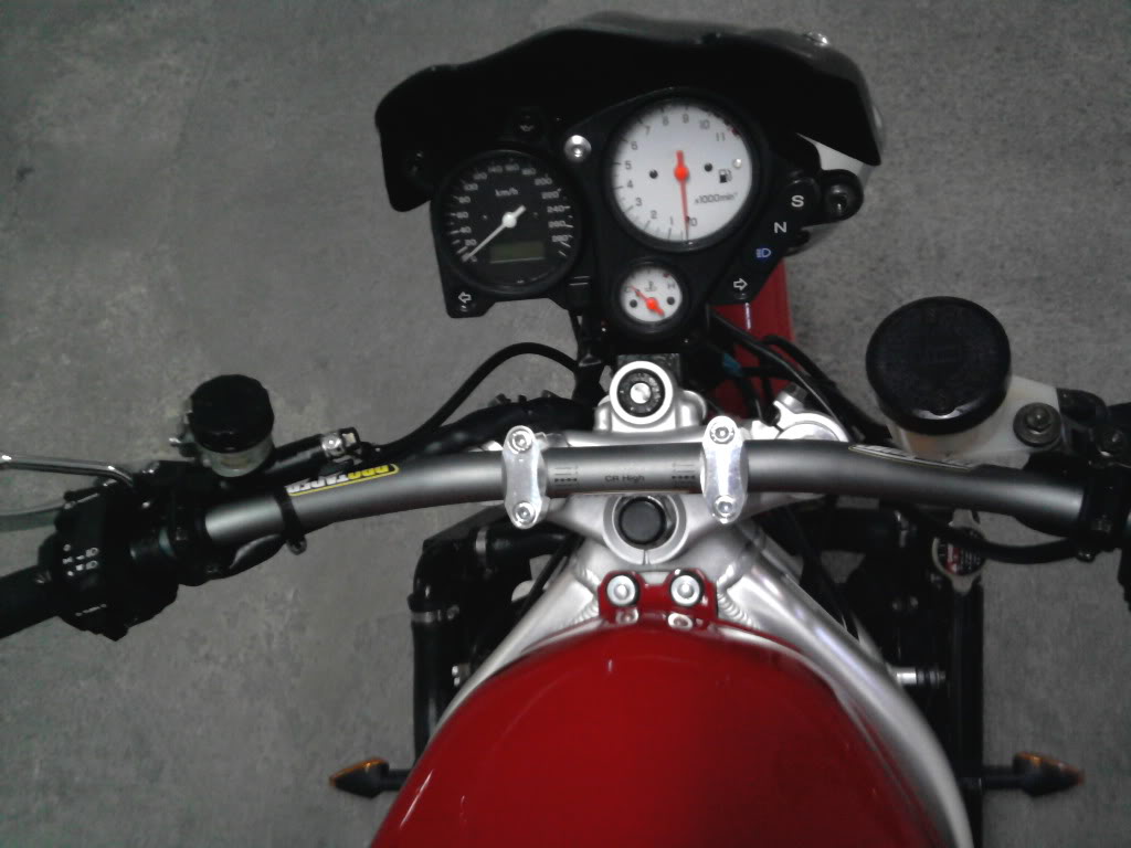

You´ve not drilled the triple yet, do you Danny?
One advice, (if i may) get the Honda plate of and drill the holes in that place.
It´s easier to drill them a bit more near the tank, like everyone does, but i´m convinced it´s not the same ride and it´s very important to get the right geometry.
Sorry about my technical english...
If you do so, your next dificulty is about those forks sticks, that will not rise up (they cant because the bar is on top of them), so if you want your front more nose down, you have to cut the bars in the down end.
Or you can just do a whole front swap as many did.
But one in doubht just look at the pictures and you´ll get the idea.

One image is better than a thousand words:
See how the bar is right on top of the fork tubes?
This i believe is one of the main thing about getting an incisive position and not a straight up torse.
Now, i could really get it even more incisive, just had to get the rear end more up, like Tweety said.
Who knows, maybe some day, but this is so good that i confess i´m a litle afraid of ruin everything.

My clamps are also 50 mm risers, they´re Scar for quads.
Your Zeta looks good Danny.
One of the pain in the *** was related with the fat bar not having much room for the switchers and comuters.
You see, the dirt bikes don´t have many switchers, so they dont need much room for it.
But yours look better.
Please do reinforce the triple with some resin or similar, cause it´s not very thicker, and i dont trust it.
My riding position now is with my nuts glued to the tank and my sholders suporting a big part of my weight.
Lot´s of fun.

The triple is more than strong enough... And the riding position you describe is really what it's about, weight on your shoulders = weight forward...
