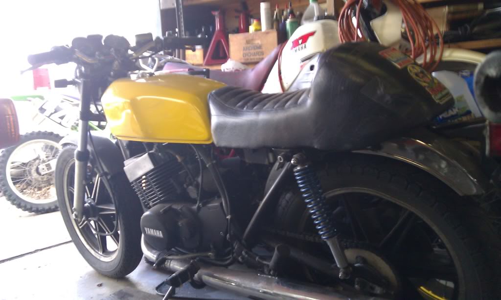

Well I figured I have had my 76 RD400 since I was 15 so it was time to give it some love.
The scheme of the build is pretty much a cafe set up. It might take a while to finish it up but hopefully this winter it will be done so I can ride it in the spring.
This is how it started exactly the same as 12years ago when my dad gave it to me as a partial bike with boxes of parts

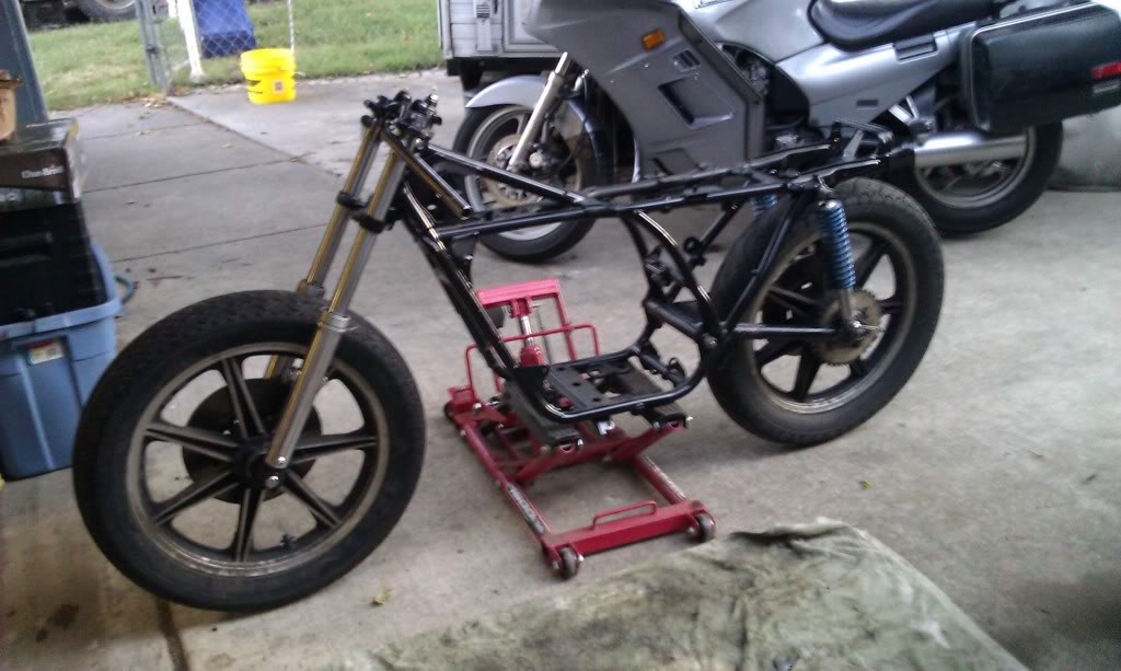

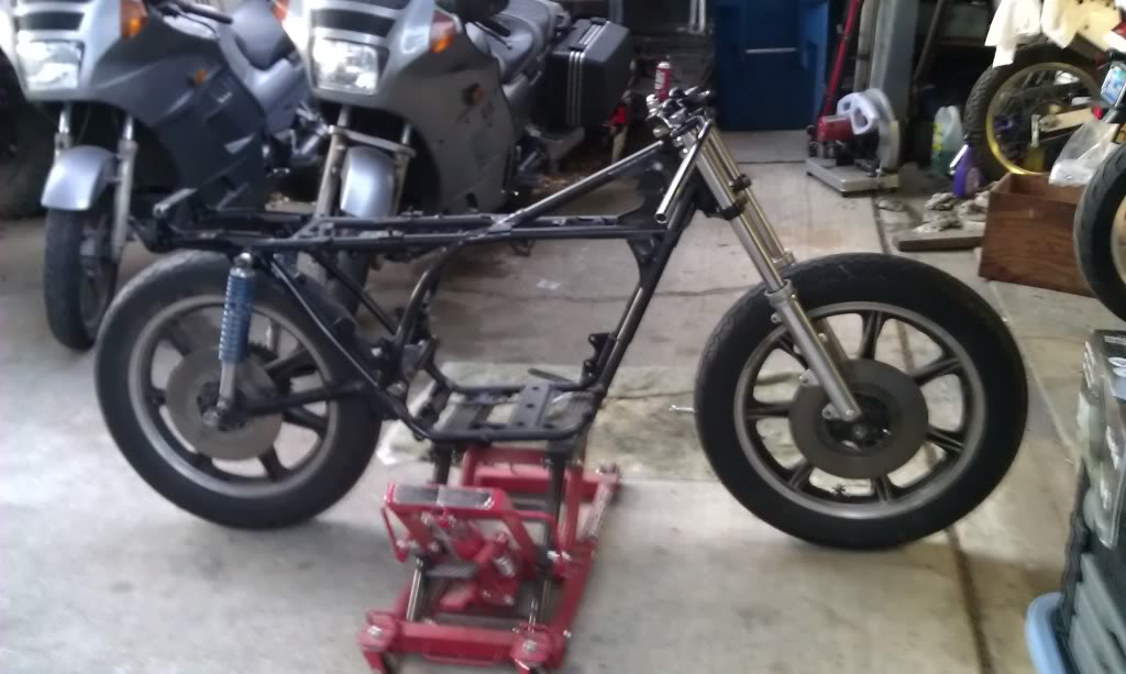

3 Attachment(s)
Got the bike set up as a roller for mocking up the tail section/seat pan and for steering clearances
Attachment 25575
Attachment 25576
Attachment 25577
