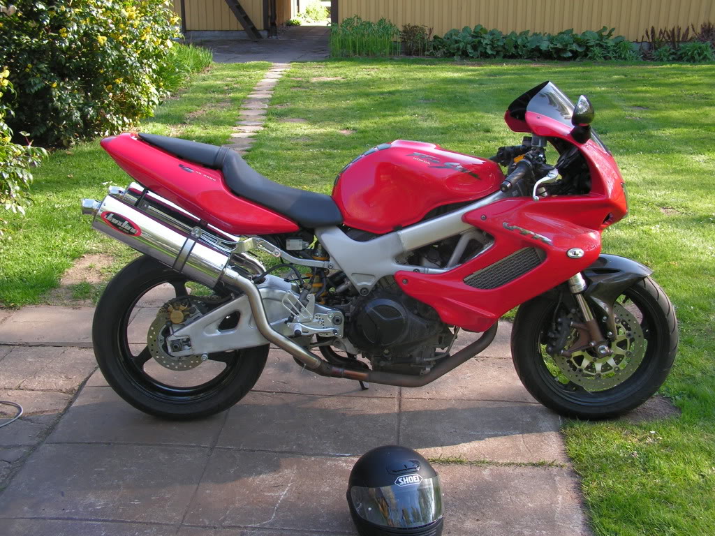

Guess What!
I'm done... Well... Almost... It's on wheels and it's stable as hell in corners... Definite improvement...

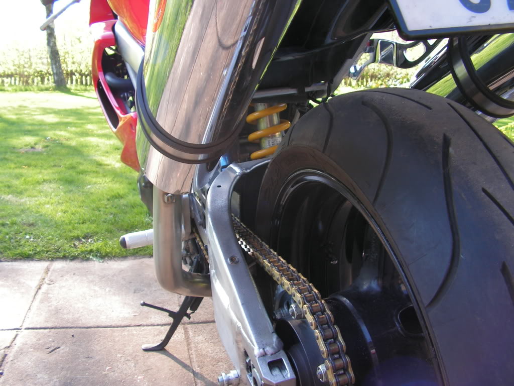

  #42

tweety
looks good !you took my mod and got on the road before me!
so hows it working out?

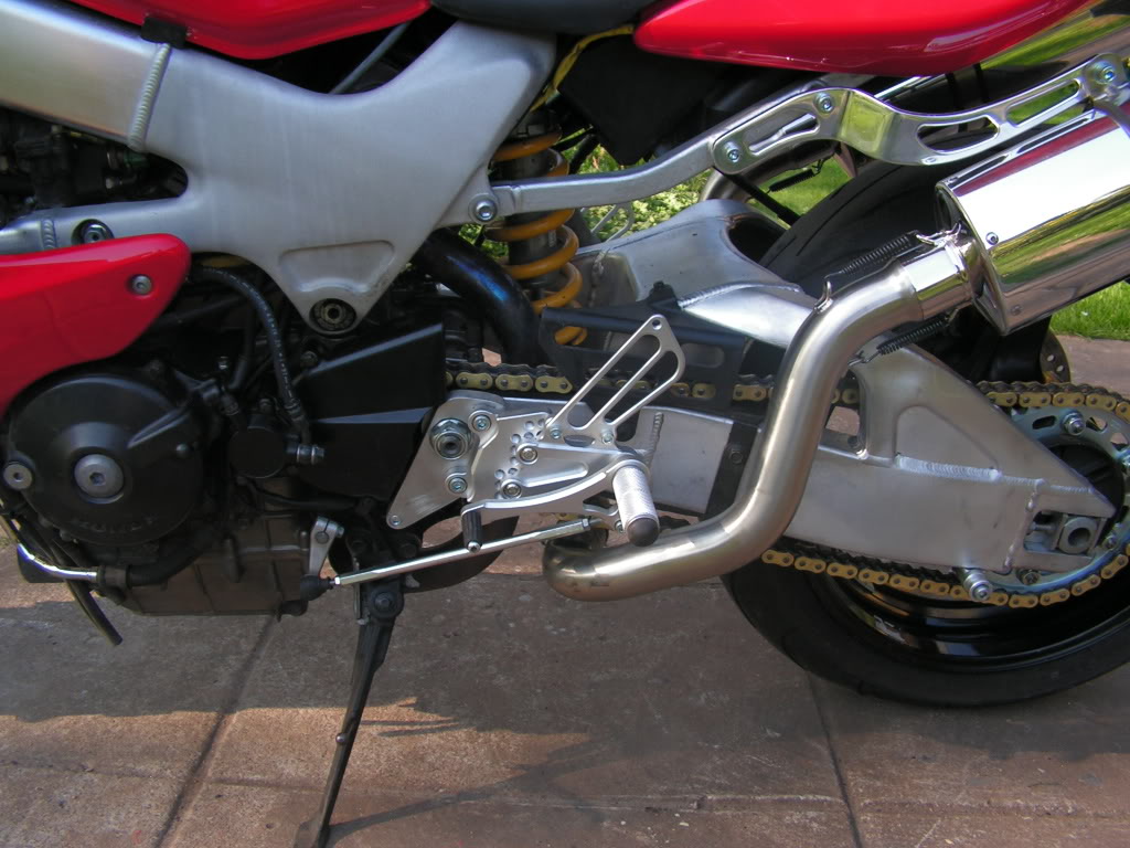

looking very good there Tweety Love the rearsets!!
FWIW, you should think about moving your shifter arm over by one or two splines, would have a noticeably positive effect on the shifting action...
When you do that, you move it back a few to make the arm more vertical right?
Old May 1, 2009 | 05:40 AM
  #46
sort of, you ideally want to get the linkage rod and shifter arm as close to 90 degrees as possible, giving you the best possble leverage (hence a shorter throw). I moved mine two splines.

tweety
i may not finish,job loss looks to be on the horizon.
Heh... Don't worry... I'll give you ride reports as soon as possible...
About 20 minutes after those pictures we where hit with one of the worst thunderstorms in a good while... At the time I was still fiddling with the levers (I'm on it mikstr!) and the rideheight...
So I nixed the ride... good thing... torrential downpour that washed away a few roads in the close area over night and very nasty winds...
And now today when it's just as nice... well... guess what... I'm working...
Oh and hawxter... You get full credit for figuring it out...

Tweety
as i was saying before ,looks great!
please be careful on your test rides.
we dont know how that weld will hold up yet.
i would hate to see anyone injured in any way.
as was asked already how did it feel?
corner entry and exits?

very nice, congrats on getting it all the way done. these projects can really get bogged down and very hard to complete. Its amazing the level of modding and enthusiasm for these bikes still. And the skill level to tackle some big jobs. nice work. Do you notice the effect of the longer wheelbase?
From the short trial I managed, yes... Stable in a straight line altough the rear is high compared to stock... Best I can describe it is that it felt like the RC51... stable movement, and it needs a firm input to go into the corner but once leaned over it's very stable and holds the line well... Before it was either twitchy or sluggish, or on a small part in between where it was in balance... Now that part is wider... steers fast but balanced...
