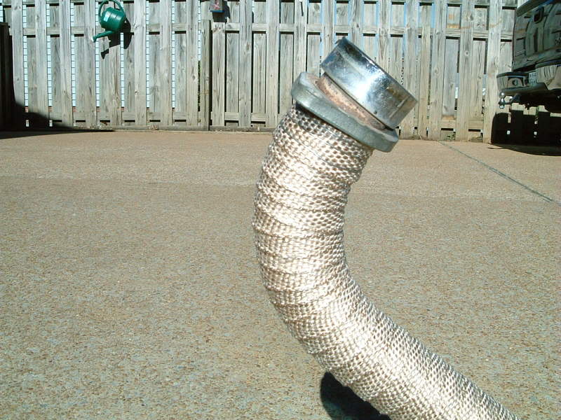

Thumper Mar 5, 2008 07:38 PM
3 Attachment(s)
50' x 1" roll is exactly what you need. I wrapped mine years ago and it lasted a long long time. I just now re-wraped it.
https://www.superhawkforum.com/forum...hlight=thumper
YOu only need to soak it for 5 or 10 minutes and pull it as tight as you can.
I do not use ugly ass water hose clamps. Instead i use to bands of safety wire, of course this is easier if you have SS safety wire and the Safety wire tool to to the works.
BTW, they make this stuff now in lots of colors. I did the same thing to my Dirt bike years ago and painted it with High Temp heat paint. It eventually looked like crap and i removed it.
Myself i wouldn't paint it, but to each his own. The pre-colored wrap looks pretty nice thou.
Attachment 31071
Attachment 31072
Attachment 31073
