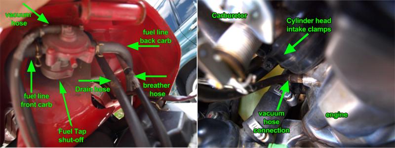

PVLIR i copy pasted to search bar looked through all the thread results & i cannot find, is this a title? not sure what im doing wrong. as for vacuum line it runs into the engine intake, not connected to carb what can i do to check vacuum line?

found threads Primary Vacuum Line Inadvertant Relocation. lines are connected properly. reading threads but not sure what to do next as far as checking vacuum. originally when i put carbs back together & installed them. there was no gas in carb or fuel lines, then i connected the fuel tank & after i started it with starter fluid, i opened both carburetor drain screws to see if i was getting gas to carbs & i was. so i assume the gas is flowing. so what am i missing?
